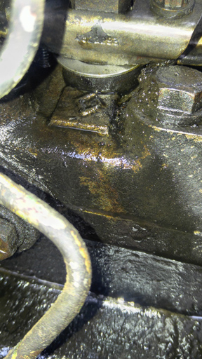

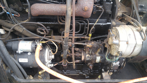

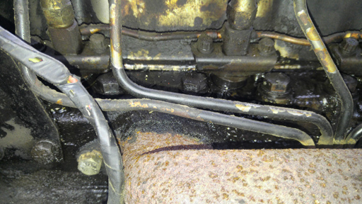

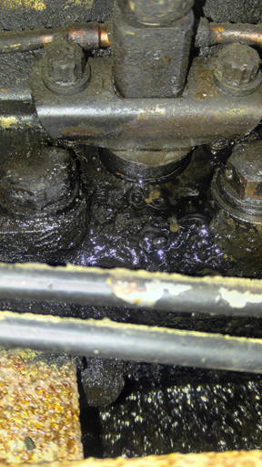

Oil Leak 3: In preparation for taking everything apart, I cleaned the engine.  I used my pressure washer and got rid of the gunk, grime and dirt.  I was hoping to run the now clean engine to see if I could see any other oil leaks.  However with the leaky radiator, I did not want to chance the engine overheating.  When I went to inspect the engine the other day to get ready to disassemble, I saw that the injector side of the engine was oily.  It looks like all four of my injectors are leaking oil.  See the following pictures.  Please note, that I have not run the engine since it was washed, so all of this oil is coming out on its own.

    Your leak by the enjectors is most likely the valve cover gasket.

 Leak at injectors, remove valve cover, clean every thing, glue a new gasket to valve cover with 3M 1099 glue. Put valve cover on a flat surface with weight to hold gasket in place over night. Throw away Phillips head bolts and replace with 1/4 x 3/4 bolts. Torque to 144 in lb. Retorque again later.     MACK

Most likely it is your crankshaft seal leaking.  Did the one on my 6080 not long after I bought it.  Also, as mentioned above, your fuel injectors do not leak oil!  The leaking oil that area is from the valve cover.  I just tightened up the valve cover bolts and my leak vent away.
