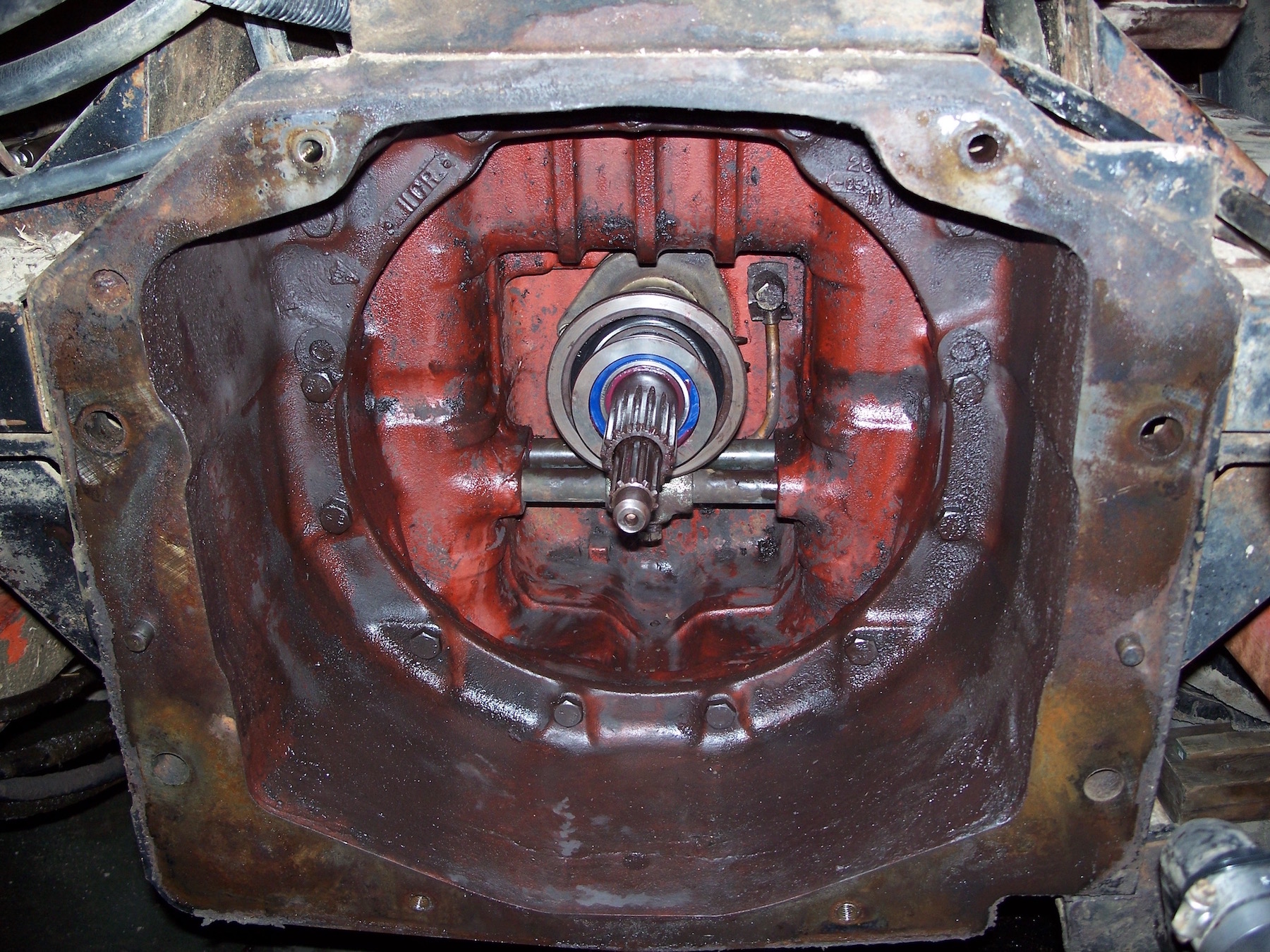

Post Options Post Options   Thanks (0) Thanks(0)   Quote Charlie175 Quote  Post ReplyReply Direct Link To This Post Posted: 23 Oct 2017 at 6:30am
Picture for reference
2075 hours on tractor, just doesn't seem like the clutch lasted long enough.
Charlie

Post Options Post Options   Thanks (0) Thanks(0)   Quote LB0442 Quote  Post ReplyReply Direct Link To This Post Posted: 23 Oct 2017 at 9:05am
Here is a picture of when I did a 6080.  Yes the PTO shaft was stuck in the pilot bearing and pulled out.  I pushed it back in, no problems with it when put together.
The release bearing forks are held on with a lock bolt to the shaft.
