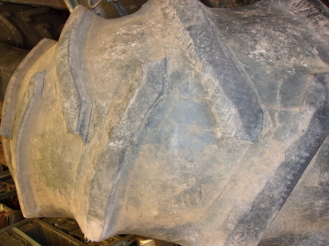

I have this pair of 18.4X16.1 tires that I had been running on my CA & D10 pulling tractors that I'd sell. The lightweight classes have died out around my area because no on could beat me. So I sold the little tractors and have these tires stored away. As you probably the 18.4X16.1 tire is about the same height as an 8.3X24.
