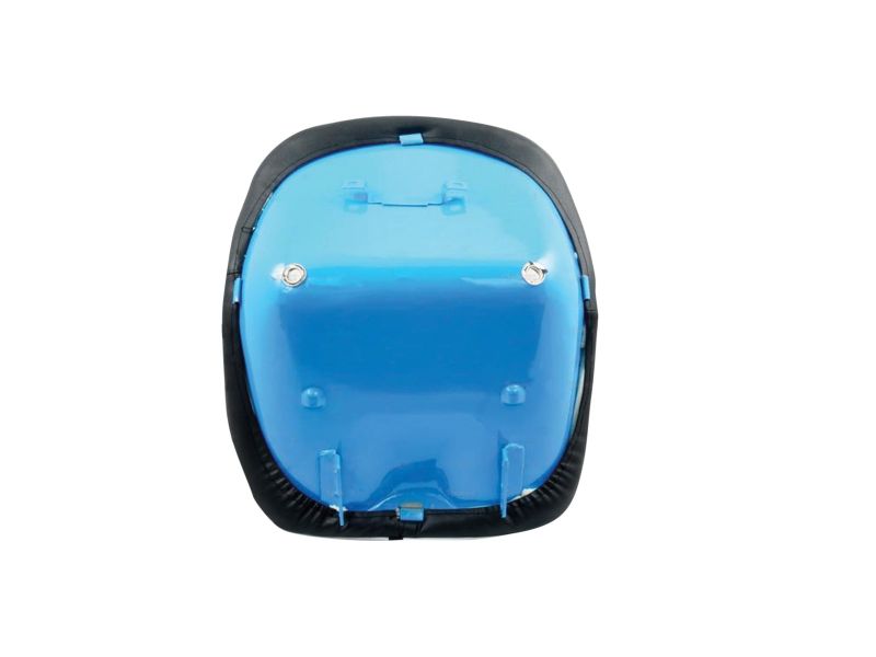

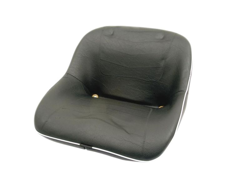

You can, in this case, choose
a   Reproduction OEM    part !
Seat Assembly for Hinomoto E16, E18, E23, E25, E28 Tractor Models
