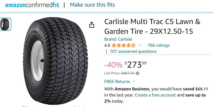

tires should be something like this.... apparently 15 inch diameter rims maybe 9 - 10 inches wide .............. do you know the bolt pattern ?

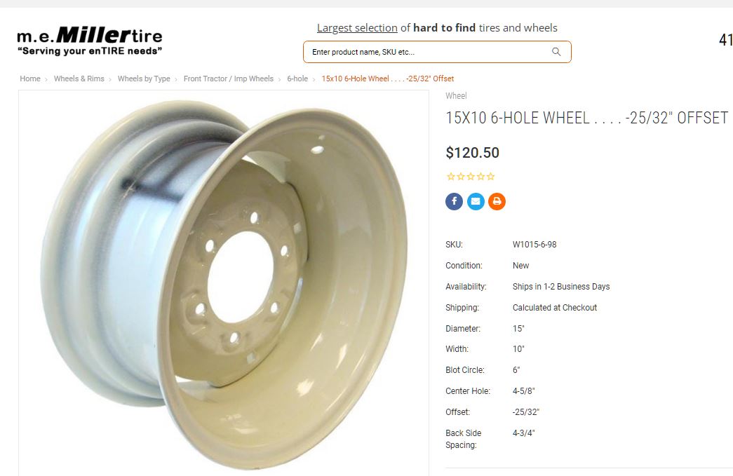

I have no idea what your bolt pattern is, but this is a COMMON 15 inch tractor rim... Note the center hole and bolt hole pattern...
