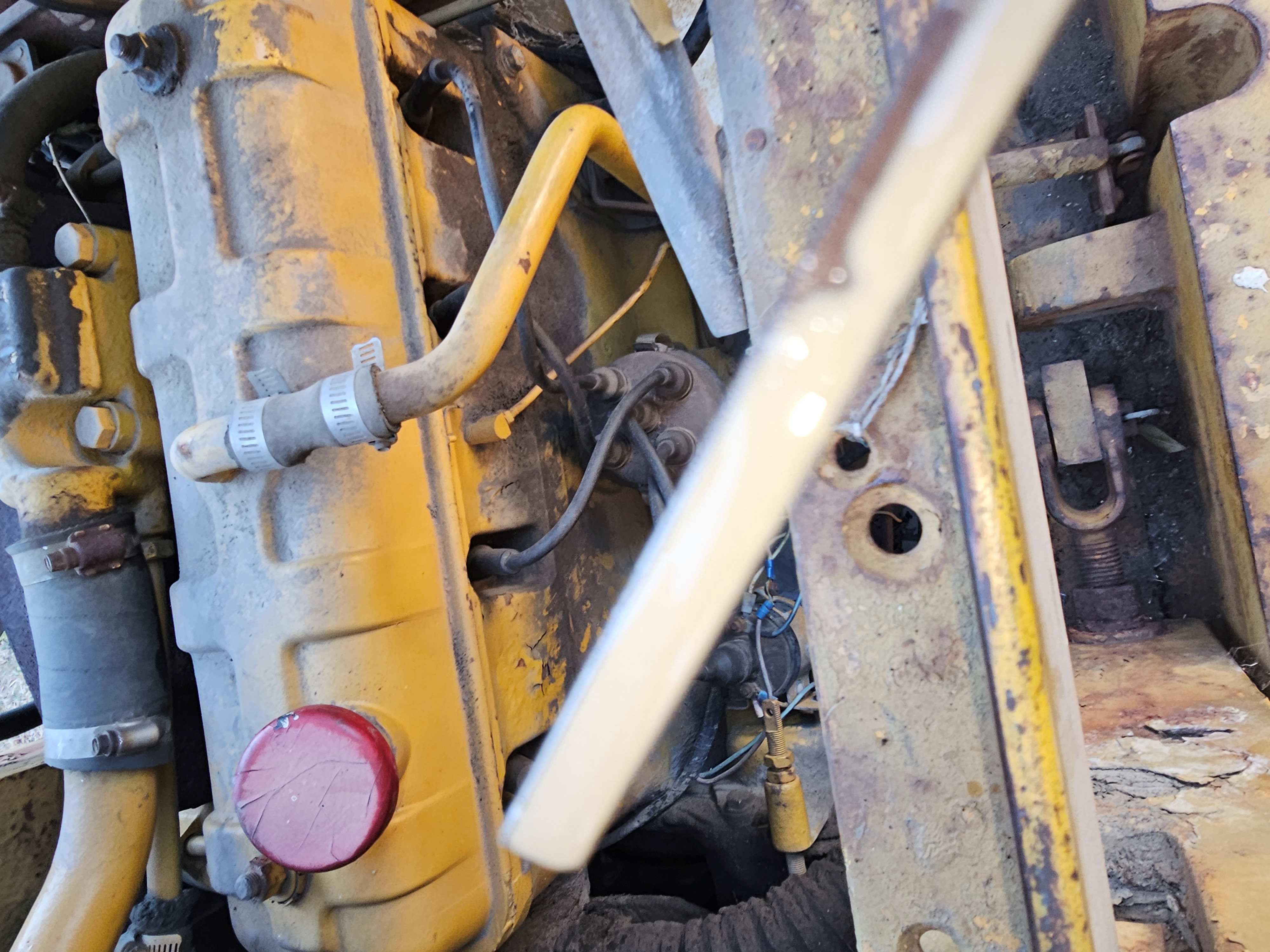

Turns out...just about everything.  I bought this simply to move some machines around my garage.  First thing that happened was the entire steering shaft came out and I needed to replace the steering from the box up.  Midwest Steering found me the correct unit and I thought GREAT!  Got it bolted up...finally, and steering is good.  THEN I checked(yah, I should have done that before I bought it, but it was SUPPOSED to have been cheaper than renter a forklift for the week) the oil....Dead.  I believe this is a Buda 153, but any help would be appreciated.  BOTH the oil and the water are contaminated.  I didn't notice it smoking when the seller ran it, but I guess it didn't run long enough....smokes a....lot.

Post Options Post Options   Thanks (0) Thanks(0)   Quote pescadoman Quote  Post ReplyReply Direct Link To This Post Posted: 13 Nov 2023 at 4:38pm

I'm up to around 1400.00 now. 500+175(delivery)+660(steering) +80(new master cylinder)  UPDATE.  The smoke was actually from some debris that got wedged in next to the muffler.  Now to fix the brakes, put in new plugs and set the valves...
