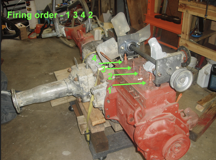

Originally posted by Dick L Dick L wrote:
Welcome aboard to one of the best boards on the net.
Number one cylinder is at the rear of the tractor. Firing order is 1-3-4-2 on the G.
With the number one cylinder at top dead center (TDC) on the compression stroke remove the distributor cap and point the rotor at the number one wire terminal. If it has been messed with you may need to lift the distributor out and reset it so the rotor points the correct direction. Loosen the distributor base and rotate it back and forth watching the points and tighten it back down when the points are closed and about to open. That will place you in time. Make sure of the firing order as this is a Continental engine not an Allis Chalmers.
On the engine, starting at number one cylinder, are the cylinders 1234 and the timing is 1342 at the distributor? I guess I am asking if the cylinders are in a normal order of 1234 starting at the fan?

Post Options Post Options   Thanks (0) Thanks(0)   Quote JoeM(GA) Quote  Post ReplyReply Direct Link To This Post Posted: 28 minutes ago at 10:14pm
Remember, engine is mounted backwards!
