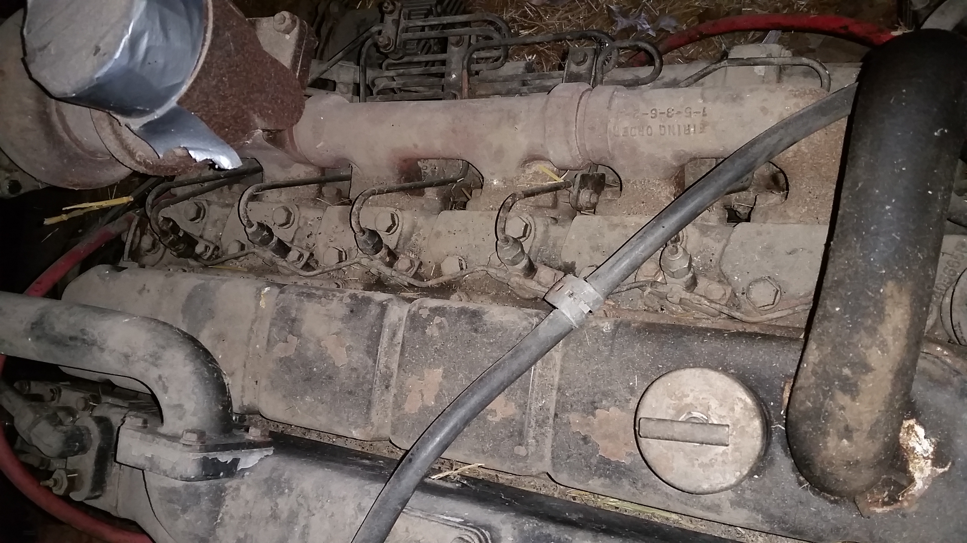

Post Options Post Options   Thanks (0) Thanks(0)   Quote MattLF9 Quote  Post ReplyReply Direct Link To This Post Posted: 30 Nov 2018 at 8:32am
You say 1980 model. So, does it have A-C injectors in it or BOSCH injectors in it ????  Sounds like you very much need new injector tips. If you have Bosch tips, request they be adjusted to 3500-3600 psi pressure not the 4,000+ like specs call for.
Maybe the injectors are Allis?
Now that I think of it the return line is on top?
If I get new tips I will be installing them myself so that won't be an issue.

MattLF9 View Drop Down
Joined: 27 Nov 2009
Location: Minnesota
Points: 187
Post Options Post Options   Thanks (0) Thanks(0)   Quote MattLF9 Quote  Post ReplyReply Direct Link To This Post Posted: 30 Nov 2018 at 9:48am
I was thinking it had Bosch injectors but they are Allis for sure.
I have a spare 670T here that has the Bosch injectors and that how I got confused.
