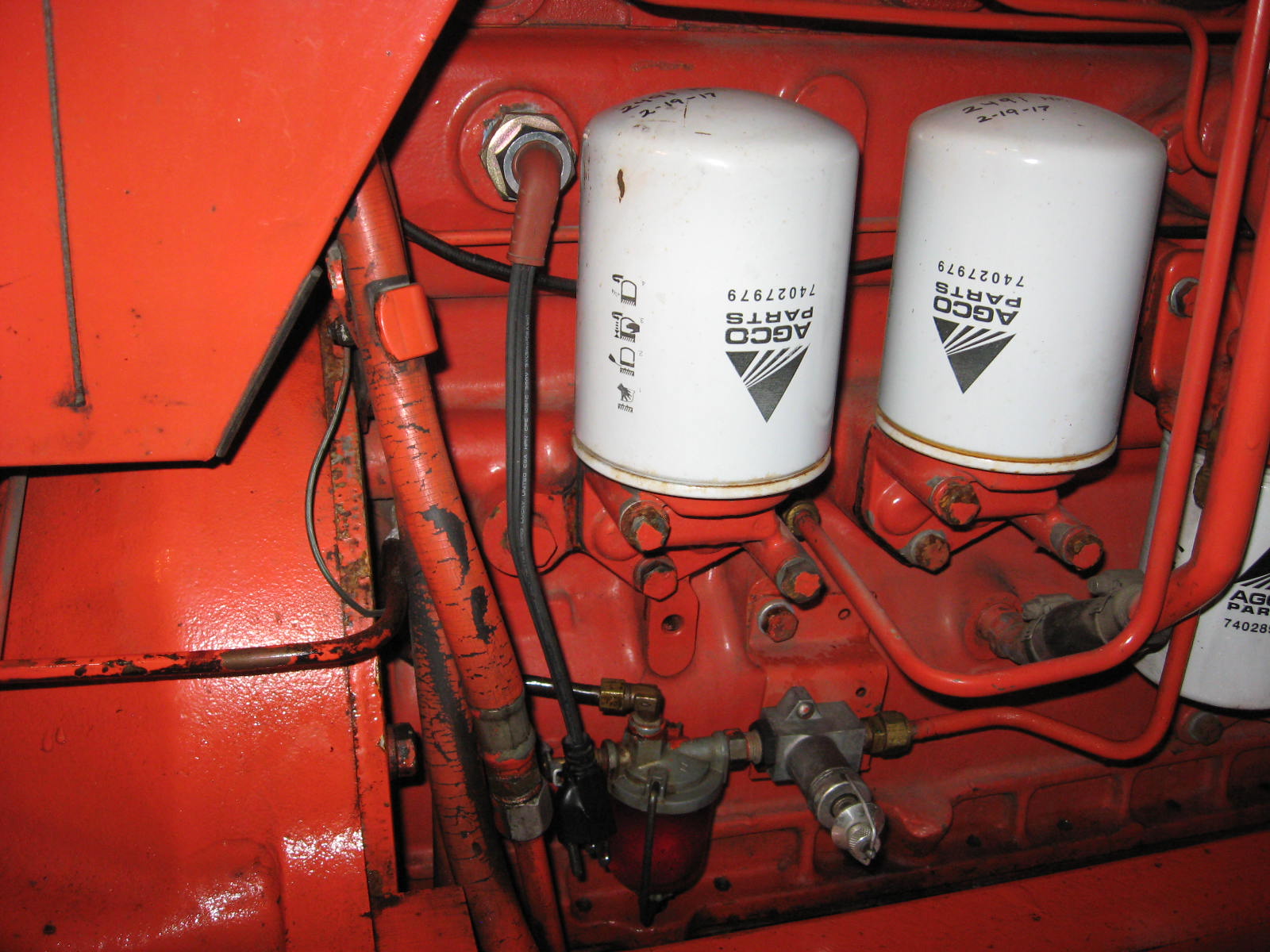

This is what I installed on my 220. It is 1" pipe thread hole to rear of oil filters.

Thanks for the picture Jim. That is where I thought one would go. Will try getting the plug out or install a tank style if it doesn't budge. Earlier 426 blocks dont have a big tube style oil cooler.

The heater is a Kat's 11407, 1" NPT, 400W. Works good. I didn't want the long cord that came with the heater hanging on the tractor so I bought a 12" cord, Kat's 28206. The heater can be bought on eBay for under $40.
