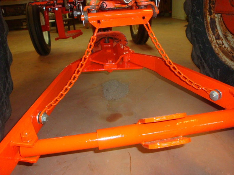

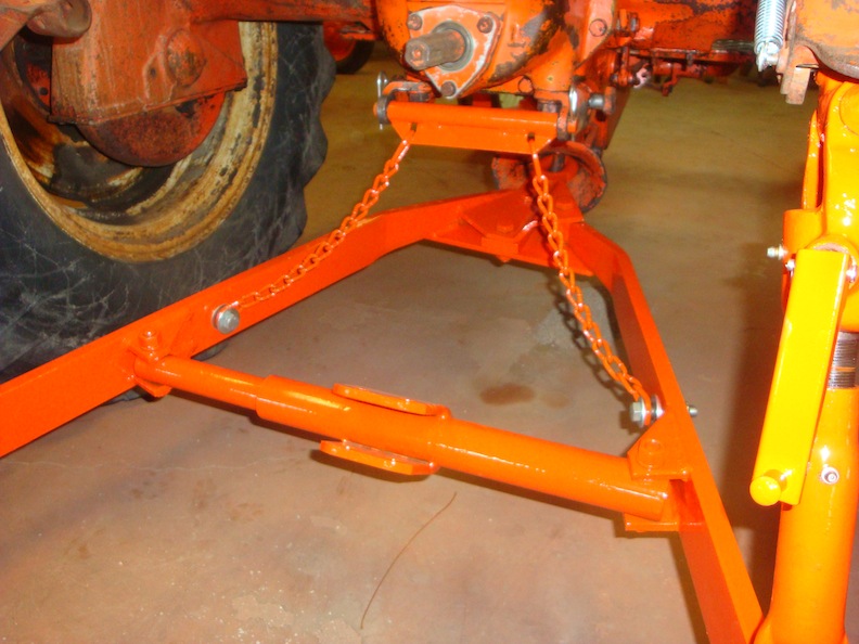

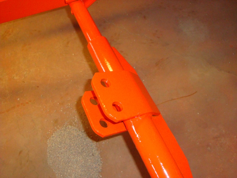

I picked up this 3pt. to use on D15 , all seems to fit correctly. Was told it came off a D19 but I don't know about that. What I was wanting to know is,what is the center bracket on cross bar used bar for ? Sway chain ?? If so it looks to be on backward for that use. Thanks

the top link connects to it

Otherwise the traction booster won't work correctly if the toplink it mounted to the tractor

Thanks - but that would be crossing the PTO shaft ???

Yes, it only works for non-pto implements
You need the top link connected that goes under the seat mount for PTO work.

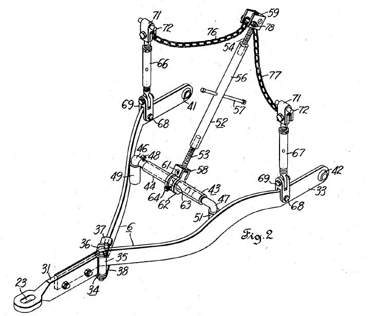

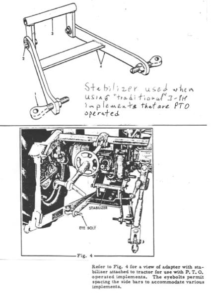

The good thing is that you appear to have a real A-C adapter.
The chains are not really for anti sway; they are there merely to keep the lower arms under control so they won't swing out and hit the tires. They are not heavy enough to control the sway of a heavy piece of equipment like a bush hog.
When PTO operated equipment is used, the 3 PH is equipped with an anti-sway device (stabilizer)  like the one in the first picture below.
The top link is then attached to a clamp attached to the rocker shaft which can be seen in the second picture.

Brian , that is the system on my D12. May try to fabricate one since one of those will be to hard to locate . Thanks
