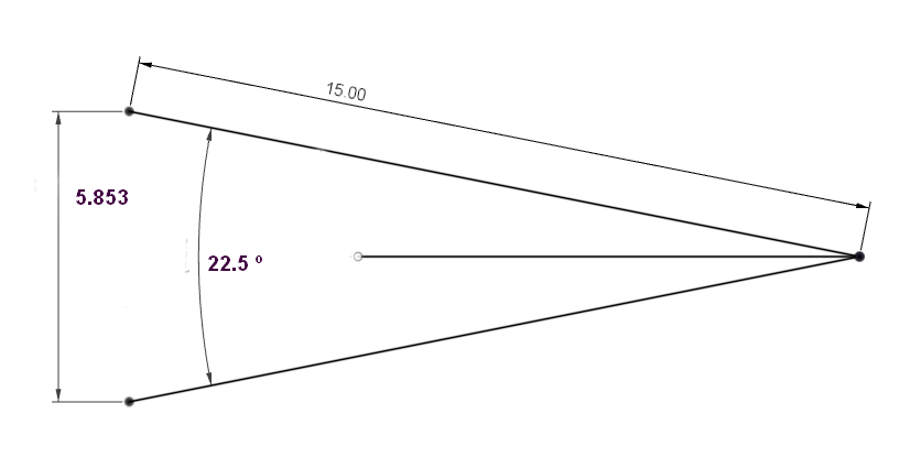

Looks like the arm has been whacked on the upper corner inside part of right lift arm.
Wonder if spline orientation is the same from the left side to the right side...?

You can remove fender and use a large puller like above to remove arm. This style puller can be set up as a 2 or 3 jaw. Clean up internal and external splines good with a wire brush and reassemble with anti-seize compound.
I agree with steve(ill).  Looks like 16 spline shaft = 22.5 degrees per spline. If you move the arm one spline and the arm is 15" -16" long, the end of the arm would move 5-6". Way too much to fix your issue. So something has to be bent or twisted. I would crank on the lift adjustments to dial it in and avoid disassembly and opening a bag of snakes.

Other than the RT shaft having been twisted as a lot have suggested; and although not likely, if there's a great deal of free movement,  it may have even sheared.
Revisiting the 1-spline index; this would be too much of a distance on the end of a 15" arm when moved one spline, compared to the picture.

I tried counting the splines on my D-14, SC arms...15 or 16 ( fender is IN the way,kept losing count.....). Tried Google, a few pictures,but no GREAT shot of the end.
Still either 15 or 16 won't make a big difference to Gatz' drawing and numbers.
