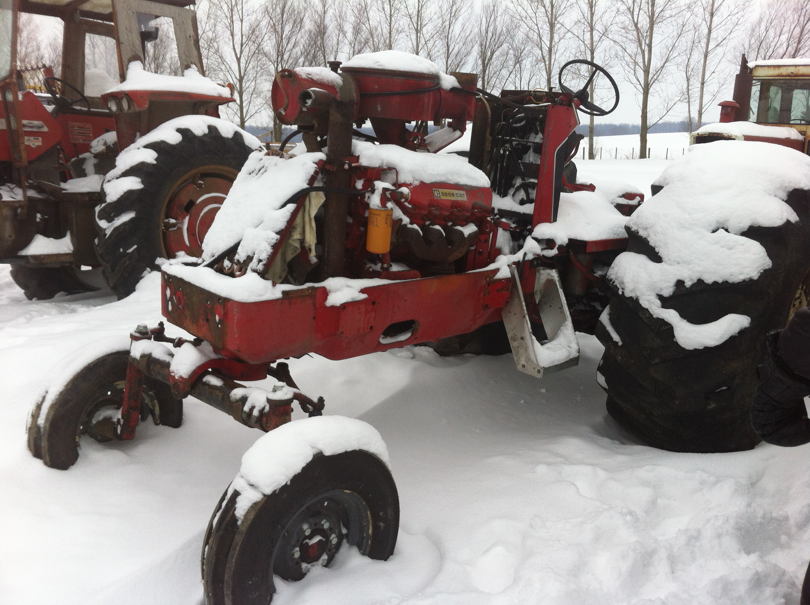

  I have  neighbours with 3208 cat in a 2255 white.  What turbo would work good  on this engine  in  a hot farm, local brush pulling scenario,   but still  a stock engine.   a lot of cubic inches  to work with here.

If you don't increase fuel delivery and RPM's you're wasting your time with a change in turbochargers.

This 2255 white/cockshutt/oliver is originally naturally aspirated but buddy would like to put a turbo on it to wake it up,  He got it as a half built puller with 30.5 cut rubber on the back and tractor all striped down.  We have came across a Garrett GT4294 wastegated turbo off a 60 series Detroit that he will likely try out.  It is for local brush pulling . Its not going on the NTPA circuit. I apologize for putting NON ALLIS tractors on this forum aswell.

3406 was and remains the best engine Cat ever made, all too many older units overhauled two three even for the fourth time and still hammering out 450-600hp.
The 3208 is junk, a disposable bored cylinder block with minimal cylinder wall thickness where they IF overbored to correct egg shape or ring worn bores will get hot. Two rings per piston, when they wore out they were exchanged as all too many tried to rebuild they would NOT last, cat would supply New "Reman" engines where the used heads would go on a new block, saw this over my career many times. A turbo on any diesel will clean up smoke but will not deliver more fuel, delivering more fuel to an already at capacity engine just eats them up faster.
