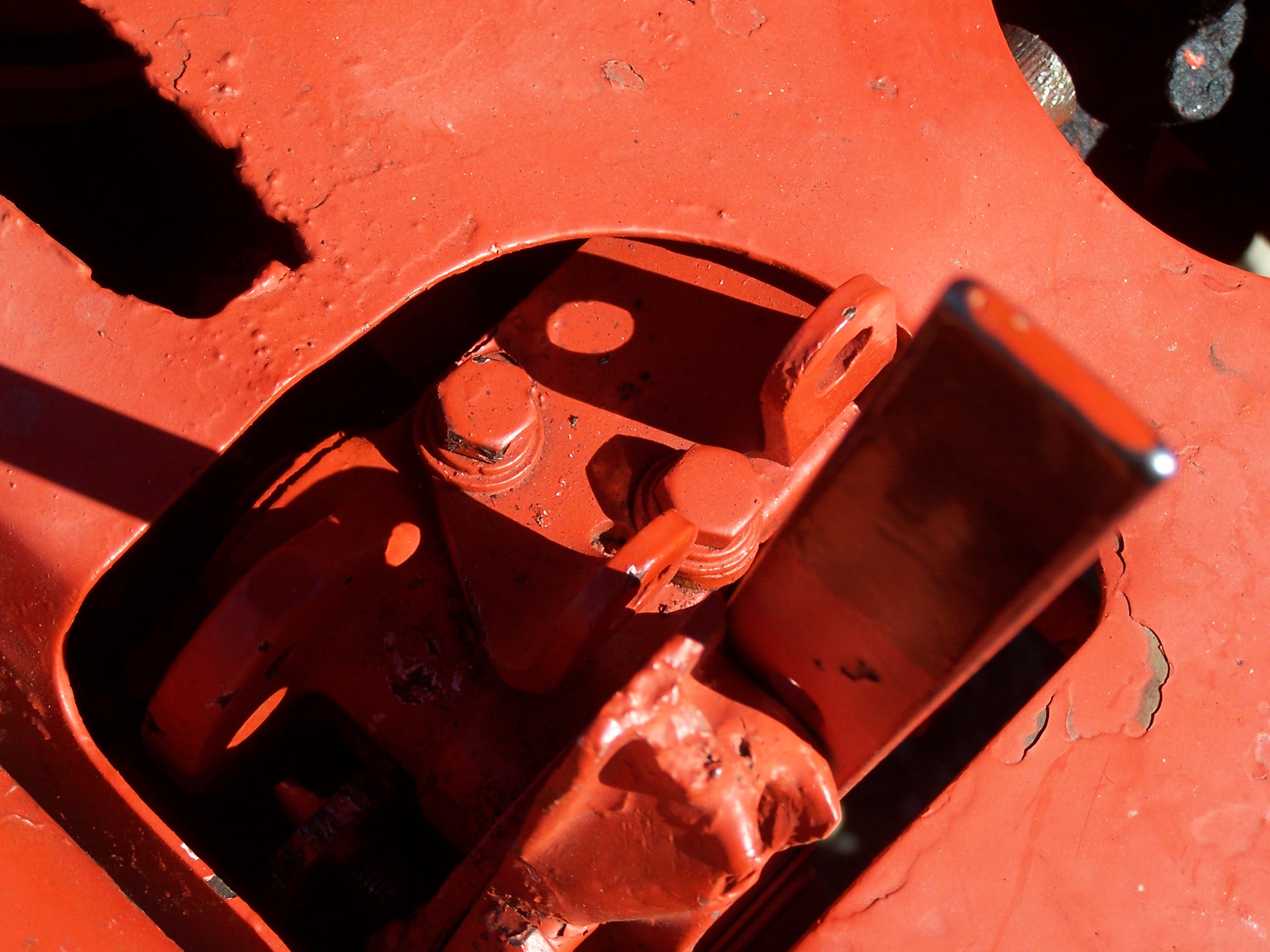

I got the screw on the hydraulic lift control handle back in, sans the screw jacket that sheared off.  There was enough thread where the jacket had sheared that I managed to get it in.  That's best shown in this pic...

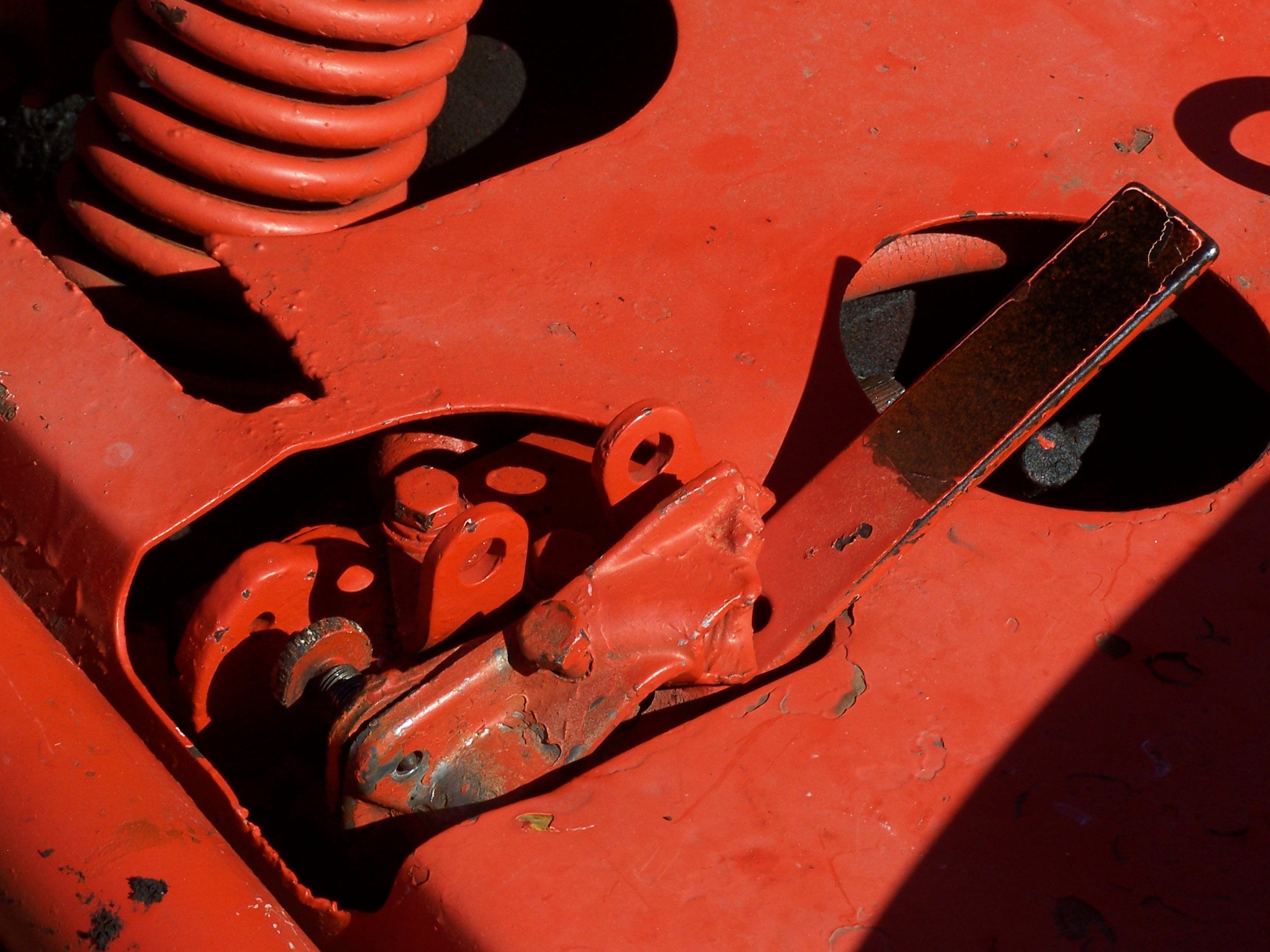

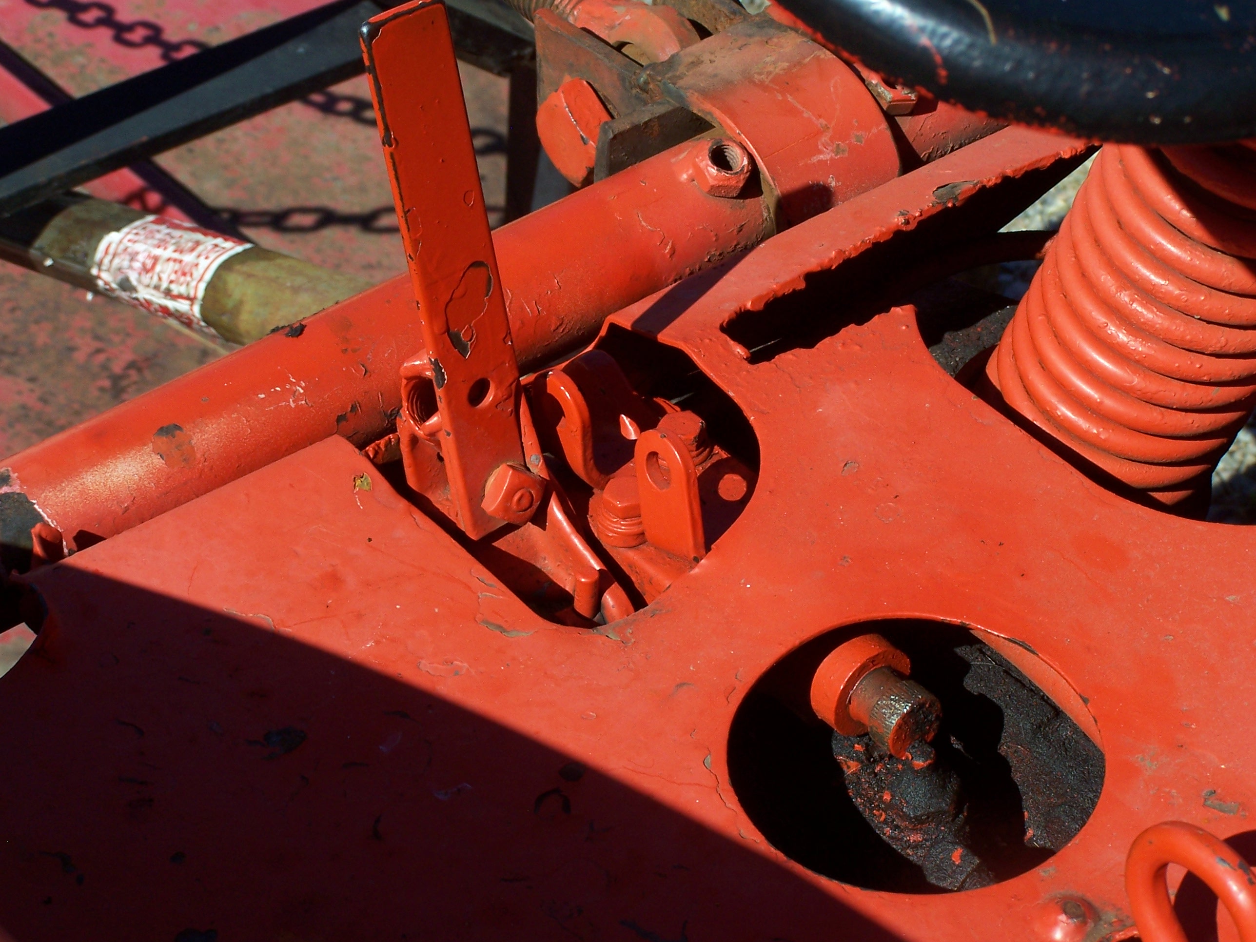

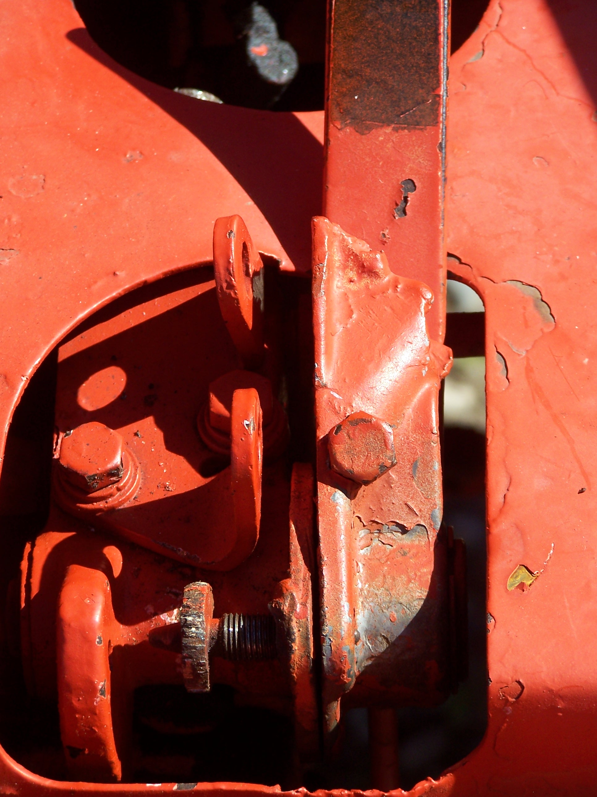

Is there something missing that I need for hold position?  I still get the handle floating up from the vibration of the tractor, vibration of the implement, and bumps I hit.  Here are a few more pics to give you an idea of what I've got...
and one from the top...
and...
Post Options Post Options   Thanks (0) Thanks(0)   Quote CTuckerNWIL Quote  Post ReplyReply Direct Link To This Post Posted: 05 Aug 2012 at 7:33am
Jim, I found this picture of the quadrant and lever for the CA.
http://images.craigslist.org/5N85E75H93G23La3H4c6jc8ba1d8878df1eed.jpg
Just above the lever in this picture is a cross bolt in the quadrant. There should be a small brakepad like disc clamped with that bolt that holds the lever in position.

Post Options Post Options   Thanks (0) Thanks(0)   Quote wkpoor Quote  Post ReplyReply Direct Link To This Post Posted: 05 Aug 2012 at 10:52am
I see evidence of a wreck in those pics. One or both of the quadrant ears are bent and probably thats why the lever bracket is broke off. Next question is why are so many CA floor pans cut? Somebody should make new ones because a nice one with no issues is all but impossible. I have one in brand new condition.

Post Options Post Options   Thanks (0) Thanks(0)   Quote Dakota Dave Quote  Post ReplyReply Direct Link To This Post Posted: 05 Aug 2012 at 11:37am
You are missing the quadrant and friction lock. My platform is not cut but when I took my Hydraulic pump and control vale apart 5 times before I got it working correctly I was wishing it had some hole cut in it. I wound up pullling the pan twice and fighting with the control valve three times working blind before I finished it up.
