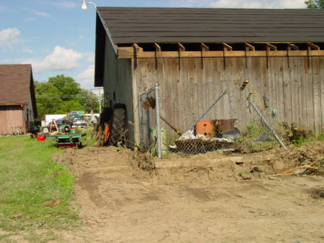

It will do all of that and more. With a loader I would take it the rear tires are loaded. I built a 500 foot drive with mine. I removed the top soil from my 100 X 70 foot molding room. I dug out my dock so the trucks backed up on the level. When the tractor was newer along with mowing the lawn I used the rotary 5 foot mower to keep the weeds down beyond the lawns. I also used it to plow and fit four acres of pumpkins several years. I now use it to clean horse lots and shelters and load the manure spreader. I use the loader to pick up and stack small square bales as well as feed hay. This week I dug out dirt in an area I need to put in batter boards for an addition on the shed along with an area wide enough to set poles. I built an land rake for it to clean up hay manure that the horses waste. That is only a small sample of How I have and still use mine. I have two now.
