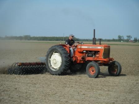

I changed my D-17 IV diesel from 16.9 x 28 to 14.9 x 38.  That's the way they all should have left the factory.

Calvin, can you get a pic of that 17 with the 38 rubber? Never seen that! Sounds interesting.....

Calvin Schmidt View Drop Down
Location: Ontario Can.
Points: 4545
Post Options Post Options   Thanks (0) Thanks(0)   Quote Calvin Schmidt Quote  Post ReplyReply Direct Link To This Post Posted: 10 Jun 2018 at 4:20pm
D17 IV D at work
 14.9 x 38" rears Factory option was 13.6 x 38" with tall front spindles
Edited by Calvin Schmidt - 10 Jun 2018 at 4:22pm

Calvin that is a real good look. What size is the front tire, are the spindles modified/extended, or did you get the factory parts to match the 38's?
The Agco parts book shows the wheel and front spindle combinations.
I also wonder how many were sold this way. A google image search shows the vast majority (of D17 pictures posted in this internet age) are 28".
