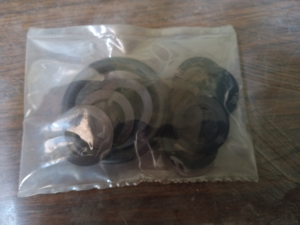

I'm slowly and with fear rebuilding my 271 engine, swapping pieces from the old block with cracked water jacket to a used block I was lucky to find on ebay fairly cheap.
These rubber pieces are included in the gasket rebuild package, but I don't know what they are for or where they go.

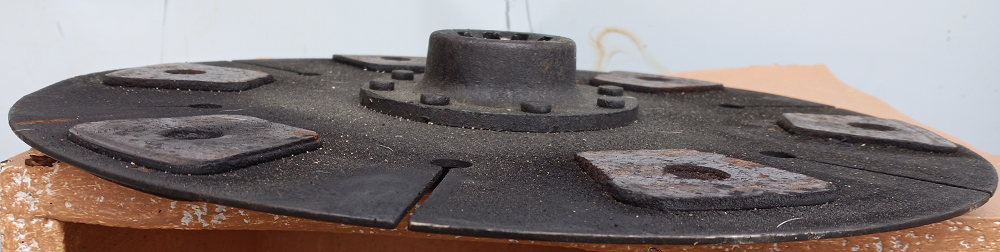

My clutch disc or drive plate as the book calls it has 0.15" thickness left.  Any place around Denver that might refurbish this?
It's 14" in diameter.

Your clutch disc is not the standard unit used on a 2-71 but a later ceramic disc type .
You will find that clutch gives no slip - in or out - but that is how that clutch is suppose to work

  Some of those go into blower - also as engine was used on generators it might have been for separate application .

The gasquet kit have all  time  some extra seals and gasquets for accessoir and for me the photo cluch is look in good condition.

Thanks for the replies.  So I'm not a fool to put the old clutch disc back in?  Sounds too lucky and easy.  I don't deserve it.

Thanks so much for that.  What should the compression reading be?  How long would it take for oil to circulate for a proper compression reading?  Would it not dumb to squirt a shot of ether to see if smoke comes out the muffler?  Is there a best place to get filters?  I have the big canister on the side of the seat.  Can one use an automotive compression tester with a rubber sealing tip?  Is there a way to tell percent of wear of the  clutch with 0.15" thickness remaining? I am told there is no need to be a full time fool when a part time fool will do.

Where to start.....uneven resistance sounds like brg out of round or bent crank....been 40yrs but think Detroit used rubber washers in oil and water transfers in counter bores and a fire ring on liner. Don't remember a head gasket but could have been? Detroit engine manuals are very thorough and able for common man to follow. Suggest you find one. Will tell you everything you need to know from rack settings, valves,timing etc.
