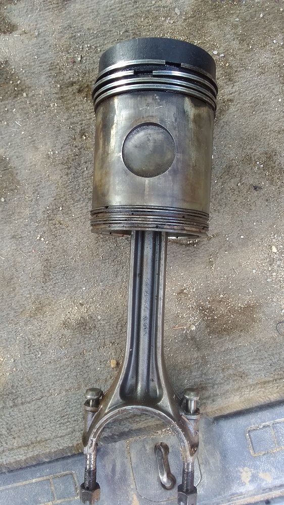

Hello Gentlemen,
I ready to get rebuild parts, cylinder kit, rod bearings, head gasket set, and oil pan gasket for my 1951 HD5G.  Would you have a recommended supplier?  Is it possible to get the pistons and rings already installed in the cylinder sleeve?  Removing the piston rod bushing looks formidable.  Can it be beaten out? The cap looks solid and immovable.
Are special tools needed to install new rings and get the piston rod separated?
Thanks so much!

Post Options Post Options   Thanks (0) Thanks(0)   Quote DMiller Quote  Post ReplyReply Direct Link To This Post Posted: 08 Jul 2020 at 2:17pm
The wrist pin end caps are Tin seals, that is the reason are dished when installed.  If replace the pistons will need the seal installer, Drive them to seat them ONE SINGLE BLOW then use a vacuum gun with a suction cup to test them, they leak knock them out try another.  Reason being the seal can displace oil to the airbox, can set up for a runaway engine, will also pressurize the crankcase also leading to excessive oil spewing.

Post Options Post Options   Thanks (0) Thanks(0)   Quote DMiller Quote  Post ReplyReply Direct Link To This Post Posted: 20 Jul 2020 at 11:59am
Two basic piston types, Trunk and Crosshead.  Trunk are all one piece as you showed, Crosshead are two piece with a replaceable skirt to a piston crown, different styles altogether as far as engine Needs and periods of build.

Post Options Post Options   Thanks (0) Thanks(0)   Quote WaltDevore Quote  Post ReplyReply Direct Link To This Post Posted: 20 Jul 2020 at 2:43pm
I'm getting ready to put her back together.  Should the pistons go into the liner before inserting it into the block or after?  The top shell rod bearings should be installed before liner goes into block?
Points: 35633
Post Options Post Options   Thanks (0) Thanks(0)   Quote DMiller Quote  Post ReplyReply Direct Link To This Post Posted: 20 Jul 2020 at 3:12pm
Pistons install from BOTTOM of sleeves, If have a liner stuffer is easier than a ring compressor but compressor will work.  Sleeves with pistons are inserted as a assembly and should be a snug slip fit.  If drop in and bounce will pull apart under heavy load.  Trial fit the sleeves before get too carried away.
