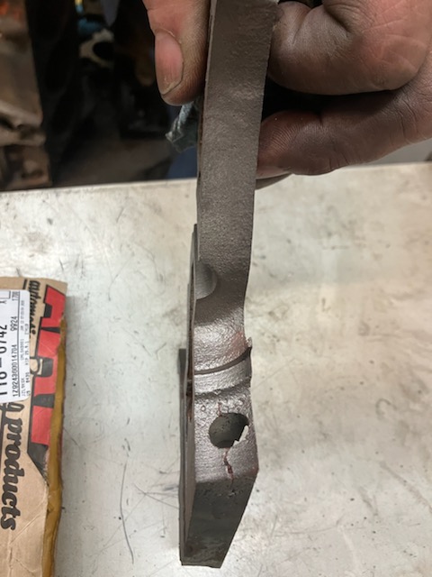

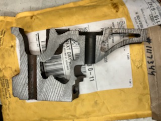

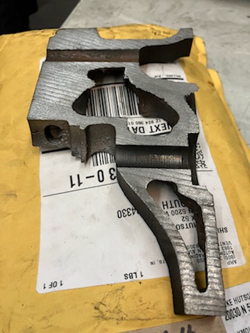

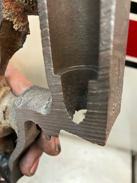

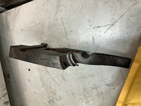

looking at some cracks in a head that is real bad to see what we are looking at in the ones that are getting rebiuldt  , it
HudCo View Drop Down
Joined: 29 Jan 2013
Location: Plymouth Utah
Points: 4065
Post Options Post Options   Thanks (0) Thanks(0)   Quote HudCo Quote  Post ReplyReply Direct Link To This Post Posted: 19 Jan 2026 at 10:47am
it looks like some is missing because its a slice right  through the middle of the port   you can see the cracking on top of the energy cell down to the vavle seat and the cracking unerthe seat that piece was magna fluxed and the crack under the seat didnt go into the water jacket
