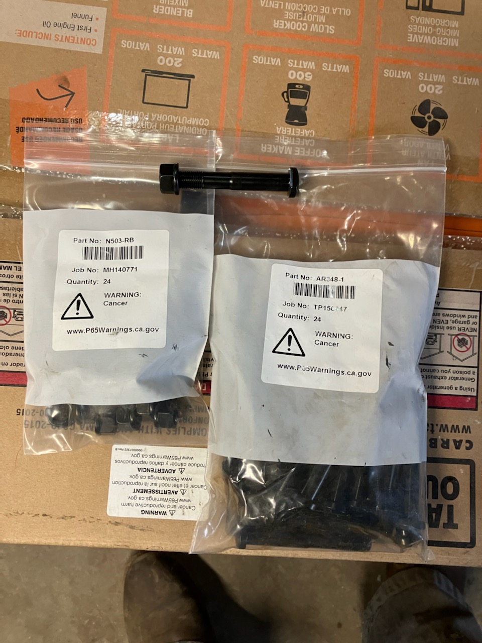

D15 D17 D19 diesel rod bolts  G230 G262 AC Buda engine
74515070  rod bolt= ARP   AR348-1   74516821 nut = N503RB nut
Just posted this for future reference ( if the search will work )
Thanks HudCo !
