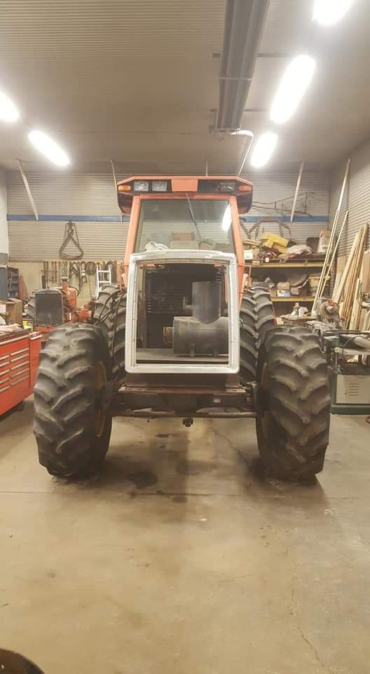

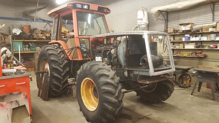

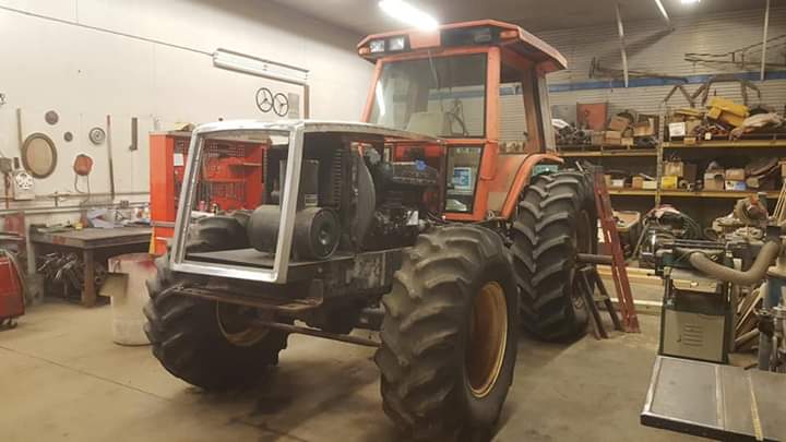

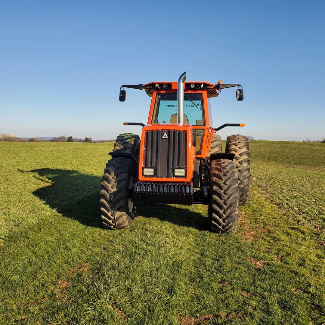

His name is Scott Becker. I dont know if he is on here. He is where I got my inspiration for my 7095 project. He fabricated a new top hood and rear side panels extensions. If I remember correctly he lengthened it out 16" and widened I wanna say 4" total. He did a full off resto after I got rhe bugs worked out. Did a hell of a job for sure. Wish I was as good a fabricator as him.

He managed to get the fan blades located half-in half-out of the shroud, which is best for max air flow.

Post Options Post Options   Thanks (0) Thanks(0)   Quote Peterson Quote  Post ReplyReply Direct Link To This Post Posted: 14 Dec 2025 at 10:31am

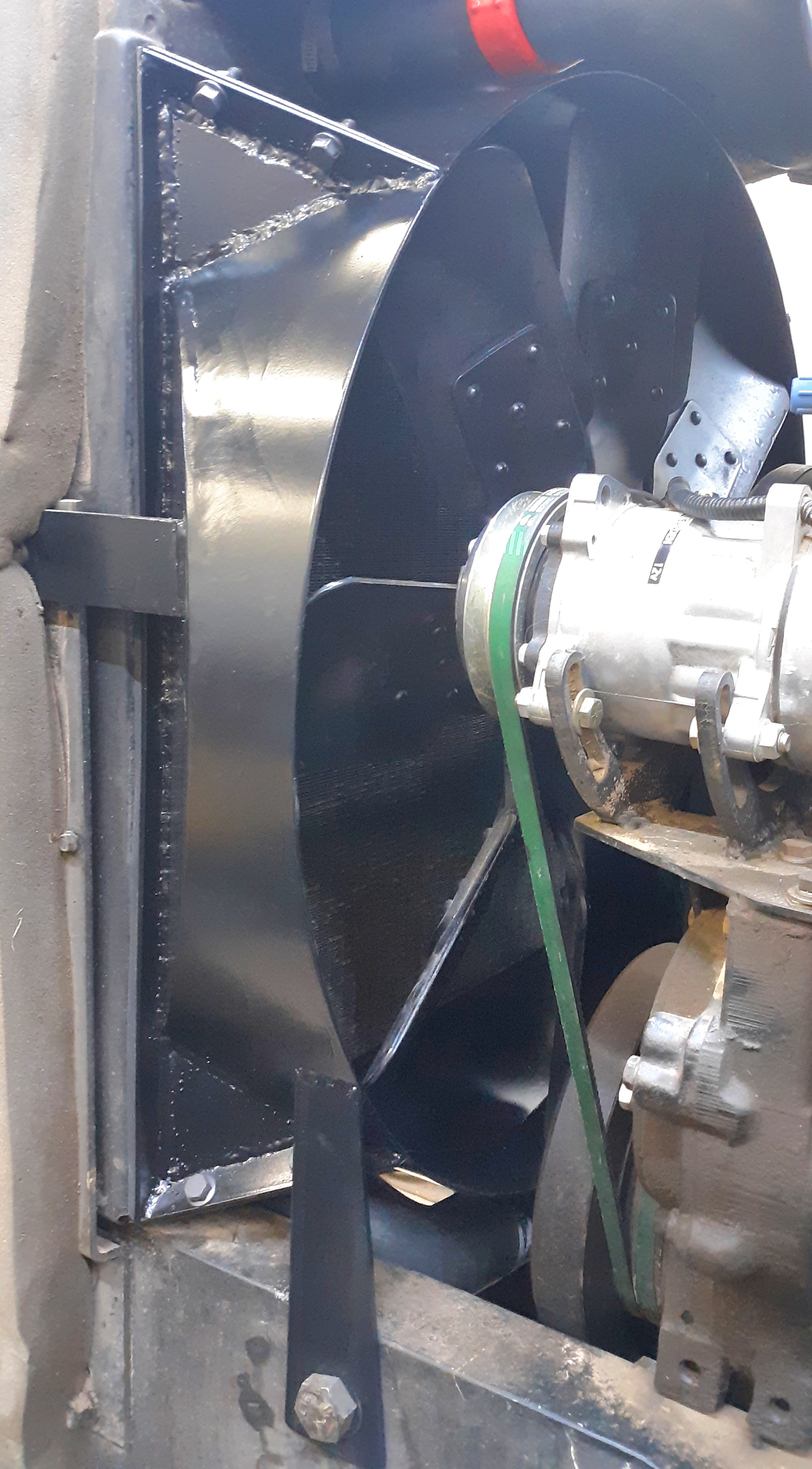

He went with a trimmed down N7 fan. Its 30" in diameter. I did the same but went with a 30" 9 blade from a semi, I couldn't keep it cool with the N7 fan cut down. I also added the extra tube in the radiator.

Post Options Post Options   Thanks (0) Thanks(0)   Quote Peterson Quote  Post ReplyReply Direct Link To This Post Posted: 14 Dec 2025 at 10:33am
This is mine with the N7 fan cut down.

Post Options Post Options   Thanks (0) Thanks(0)   Quote AllisFreak MN Quote  Post ReplyReply Direct Link To This Post Posted: 14 Dec 2025 at 11:38am
He must have had to widen the grille and the shell to fit the wider hood top? How did he do that and make it look so good?

Post Options Post Options   Thanks (0) Thanks(0)   Quote Peterson Quote  Post ReplyReply Direct Link To This Post Posted: 14 Dec 2025 at 11:40am
His family business is fabrication. He built the front grill frame and everything. Only factory piece is the side panels.
