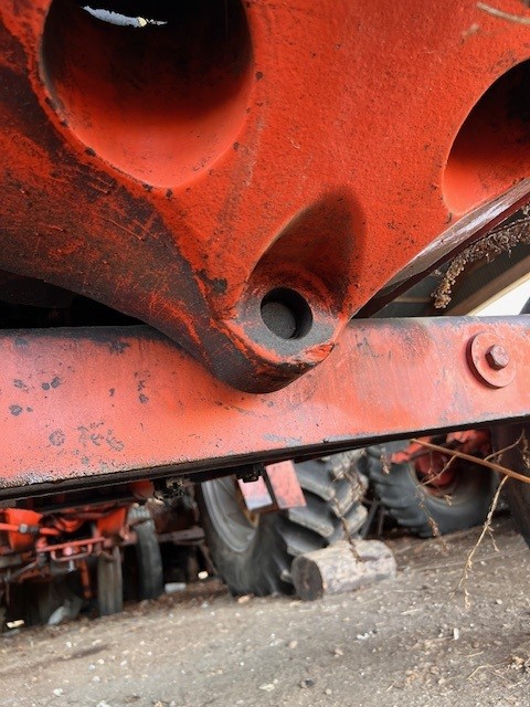

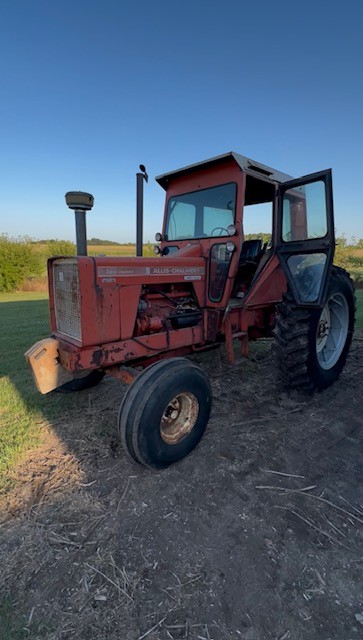

Here is a picture of the underneath of my front axle bolster.  I'm not sure which one it is but seems heavy.  Below is a picture of the weight bracket.  It is planned to remain as I don't have the block weights.

If it looks like you could put a socket on the front crank pulley easily too turn the engine over, it's the hollow one. Still very heavy, at least 600#, but the early one is solid all the way to the crank pulley, it would be challenging to get that socket and rachet on the crank bolt. The hollow one has enough room to remove the pulley actually. I bet the solid one is over 900#. I don't think the early one has those 2 big holes either. I always assumed the hollow one was designed to help "cheapen" the price for the 210, and once they came out, it just made sense to just use the same one on the 220, and sell a rack of suitcase weights to the buyer. I don't think there's an official serial number break, but it would be interesting to know about when the 220 got the hollow one. I'd guess sometime in 71, guessing it would have taken a while to use up all the solid ones they had made already.
Looked on agco parts books online, the 210 & 220 both call for 70256109. Shows serial # effective after 2036 for 210, and that is for the larger 5/8" bolts that hold the radiator surround. My older paper parts book copy shows for a 210, support #255790 and also shows 1/2" bolts for radiator surround. Oddly it shows no different part number under 220, but the picture clearly shows the solid casting and the 210 picture show the hollow one lol!
