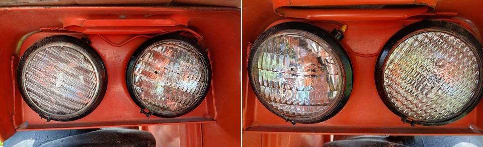

If you have a light with the triangle in the middle of the lense and has a G in the middle of the triangle, that is a GUIDE light... A-C used the Guide light assemblies in the productions of their tractors.
Below are a set of lights on a 170
 https://www.allischalmers.com/forum/uploads/242/right_left_lights.jpg
First light is a 4410 back-up light produced by Guide, lots of fluting in the glass.Was also used as a rear work light.
Second light is a GE H7610 halogen 50 watt. If you use these lights, I suggest to either put them on a seperate toggle switch or control them thru relays from the light switch. I smoked a good light switch because I had 3 Halogens on the switch. I put in a toggle switch for them and that has worked very good for me.
Third light looks original to the tractor, It is a Guide 4411 35 watt 'utility'. Dealer parts book calls it 'Road headlight',  part number 230232  .
Forth light surprised me when taking the light out, It turned out to be a GE 35 watt rear tail light/ red light #4409 4tractor6.  Parts book labels the sealed beam as #235583
  As for the field/work light, think the number on that was 4406.  Allis had a part number of 239804 for the sealed beam field light.
  I would put the larger fluted lights in instead of the multiples, just seamed brighter to me.
 Years ago I use to have a list of manufactures and number to identify what light would cross over but can't find that list anymore.

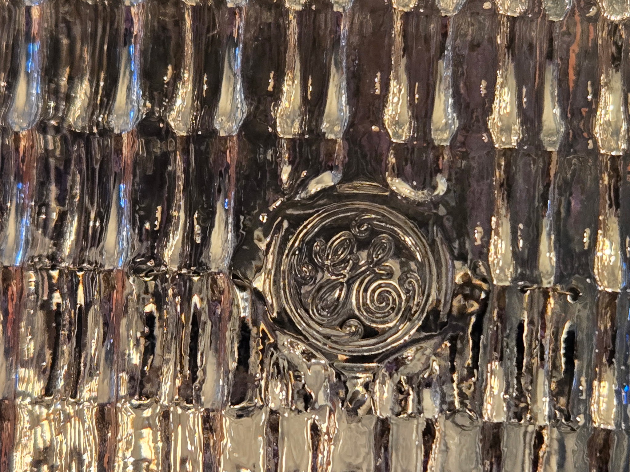

Post Options Post Options   Thanks (0) Thanks(0)   Quote Kevin210 Quote  Post ReplyReply Direct Link To This Post Posted: 19 May 2025 at 6:53pm
We are pretty sure these have the number 4406 on them as well.

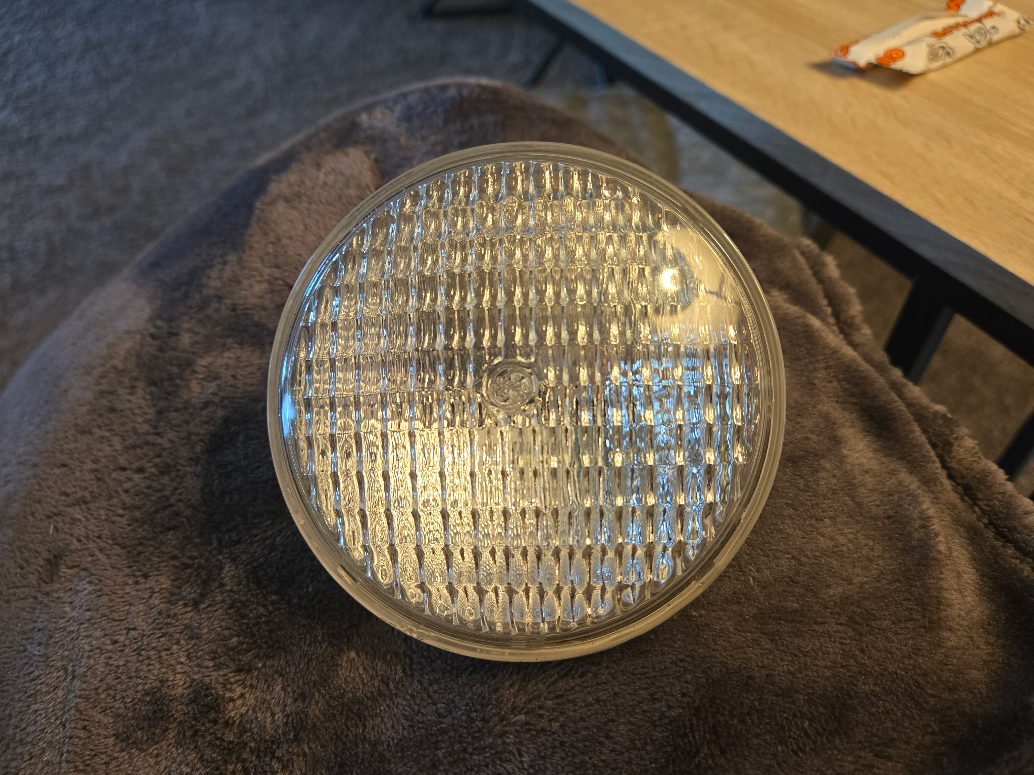

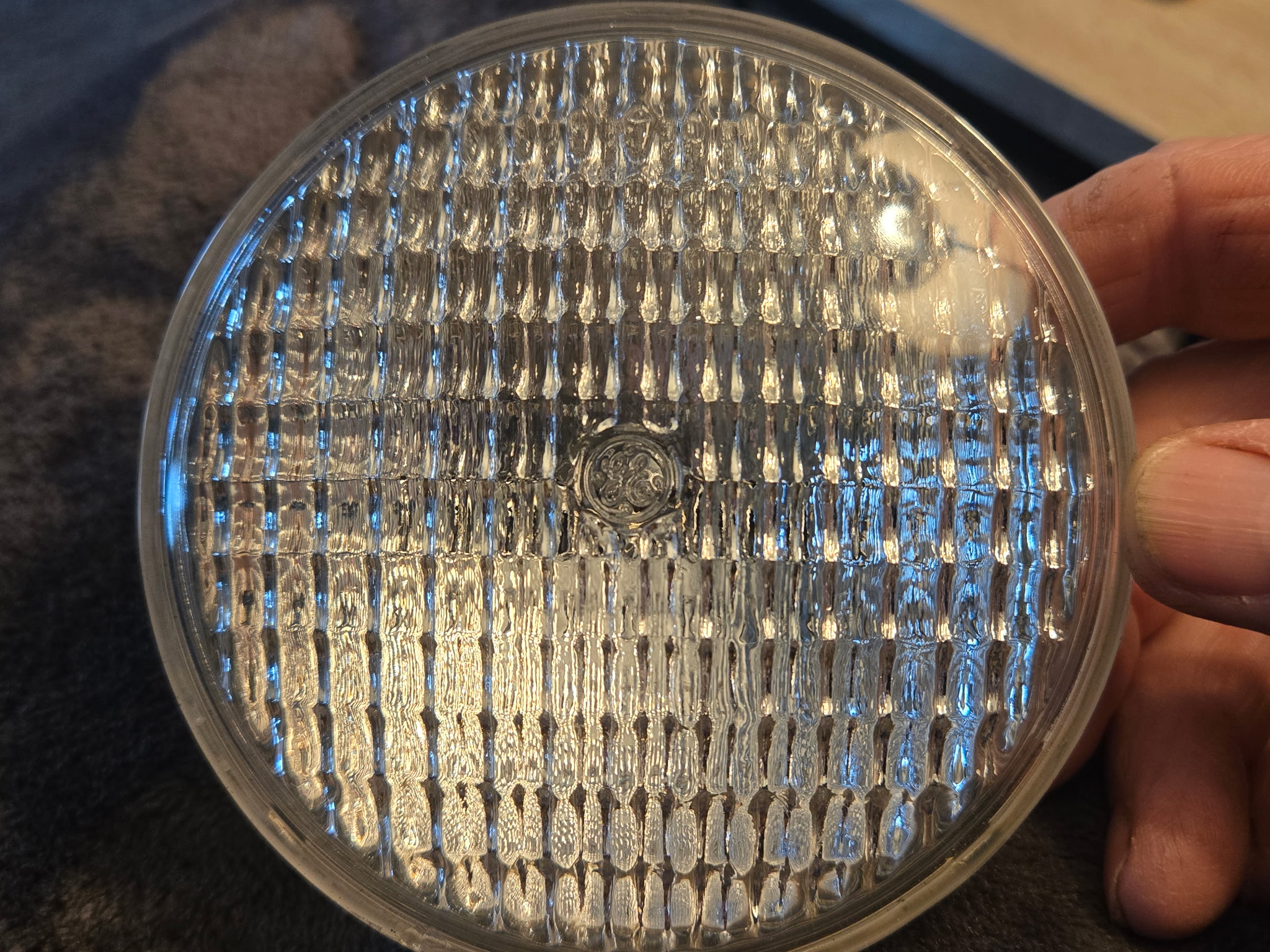

Post Options Post Options   Thanks (0) Thanks(0)   Quote Kevin210 Quote  Post ReplyReply Direct Link To This Post Posted: 19 May 2025 at 6:57pm
This what I have and want 2 of the same.
