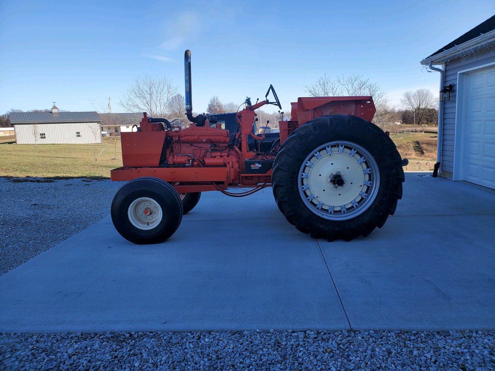

Still working on it.

Wow, that's coming along really well. Is the engine original or is it a later series?

That's actually a MK II 3700 irragation motor I found in Nebraska
a few years ago and overhauled it.

Soooo, did you use the original front plate so that the hydraulic pump would mount or did you fashion a hole in the 3700 engine to mount it. Also, are you using the original DB injection pump,a DM pump,or did this irrigation engine have an inline pump of some sort?
Kevin210 View Drop Down
Joined: 08 Oct 2018
Location: Indiana
Points: 462
Post Options Post Options   Thanks (0) Thanks(0)   Quote Kevin210 Quote  Post ReplyReply Direct Link To This Post Posted: 23 Apr 2023 at 8:17pm
I used the 210 front plate off the 3500 motor.
Yes I had to make the plate work because it would not
bolt to the motor due to the oil pumps being made different.
I just didn't use the original plate on the 3700 simply because
I wanted to be able to bolt to the frame rails without having to
get angle pieces,I wanted it to bolt to the frame and so it does.
I used the 3500 pump simply because it was already altered and kept
the dm pump off the 3700,and the fuel lines are bigger too but they
wouldn't work on the 3700 motor so I took the tractor to scheid's in
Terra Haute and they made new lines to fit the 3500 pump and 3700 motor..

You're using the 210/220 model "DC" injection pump with custom made injector lines that work with the 3700 Mark 2 oil cooler ???  Injectors are A-C or Bosch ? I assume A-C.
Joined: 08 Oct 2018
Location: Indiana
Points: 462
Post Options Post Options   Thanks (0) Thanks(0)   Quote Kevin210 Quote  Post ReplyReply Direct Link To This Post Posted: 23 Apr 2023 at 8:55pm
Yes Doc,that's why I took the tractor to them to get lines made
to make sure they fit versus having them make them then bring them
home and maybe not fitting and having to get more made,one time trip.
Yes it has A-C injectors in it that were lasered,and I can't recall
which ones exactly but I paid a lot of money for this little project
back in the 90's.
