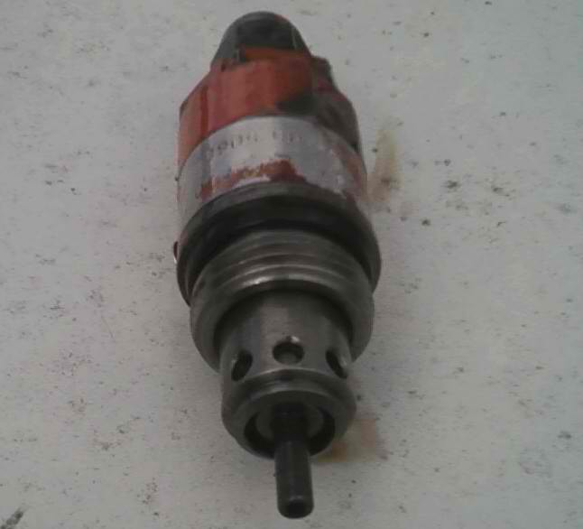

I have replaced pump from salvage yard about 1 1/2 yr ago have to have rpm at about   2000 in order to raise implement. I am only able to adj relief psi to 1100 at remote. I removed relief valve to check it {thought it might be stuck or something}. Should there be a ball in front of it? see pic I can't see my diagram in book good enough to tell. Could this be another bad pump ? PS I changed  oil and  cleaned screen  has new suction  hoses and clamps. tia Bill

No there is no ball in front of it. Are you adjusting the right relief valve? There is 2 on it. One for traction booster and one for 3 pt and remotes. Easest thing to do is switch places with them.   MACK
