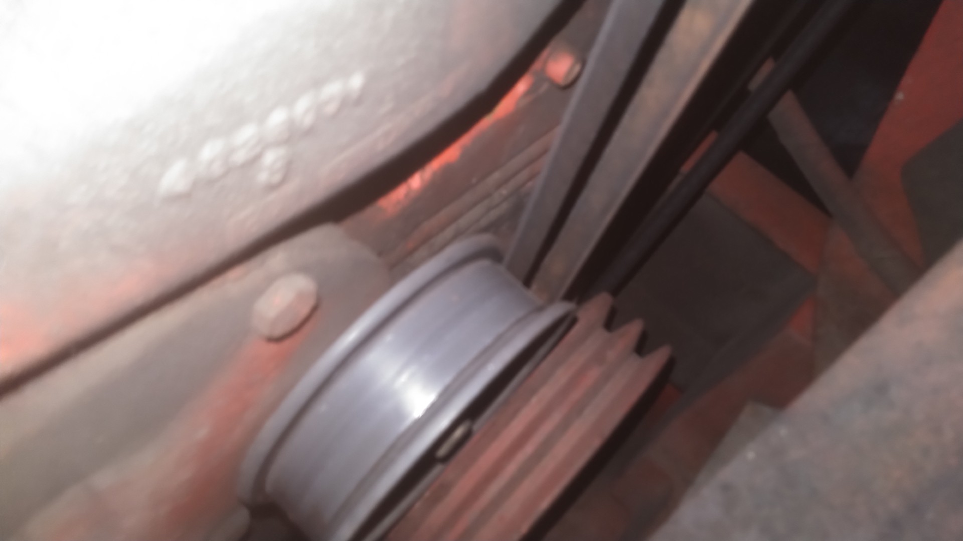

The pulley on 210-220 addition that will help wrap the water pump pulley and crank pulley. This is a special flat pulley used on F series and other Gleaner combines .  Remove the inner bolt on the front timing /pump cover and install longer bolt with shims to align pulley. Works to lengthen life of belts.  PN 71178651
