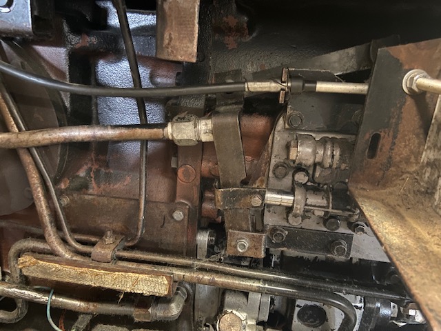

Post Options Post Options   Thanks (0) Thanks(0)   Quote SMRDIESEL Quote  Post ReplyReply Direct Link To This Post Posted: 22 Jul 2024 at 5:42pm
this is the lever i am talking about

Post Options Post Options   Thanks (0) Thanks(0)   Quote SMRDIESEL Quote  Post ReplyReply Direct Link To This Post Posted: 22 Jul 2024 at 5:45pm
we have to take the cab off to replace the return spring?
would you have the instructions?
i really appriciate your help!
Points: 22174
Post Options Post Options   Thanks (1) Thanks(1)   Quote DrAllis Quote  Post ReplyReply Direct Link To This Post Posted: 22 Jul 2024 at 6:05pm
I never said anything about removing the cab. Remove both left and right hoods. Remove the short rear center top hood by releasing the spring hooks.  Standing on the ground, open the cab door. Remove the metal strip holding down the floor mat and roll the floor mat back under the seat. Remove the black side panel that is straight in front of you. Remove some of the bolts to the black panel above the steering wheel tilt release. Now, your goal is to remove the LEFT orange side panel above the clutch pedal. This takes more bolt removal and probably another top panel to the instrument panel. The broken spring is inside that orange panel and above the clutch pedal.
