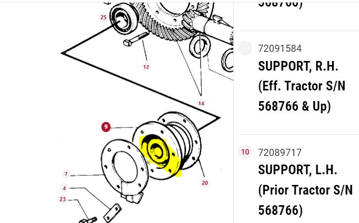

Hi,
I am looking for some help on a part number/size of a seal. We are doing the brakes on a 1980 Allis Chalmers 5050 and need to replace the seals inside the right and left support brackets. On the Agco parts website it does not list this seal, just the support as one whole part. Could anyone point me in the right direction on this? Thanks,

Page 83.......72090076 is what I come up with.
Points: 8755
Post Options Post Options   Thanks (0) Thanks(0)   Quote Mikez Quote  Post ReplyReply Direct Link To This Post Posted: 13 Jul 2023 at 8:09pm
Per dr part number agco switches to 72090424v and is still available

Post Options Post Options   Thanks (0) Thanks(0)   Quote trueblue Quote  Post ReplyReply Direct Link To This Post Posted: 31 Jul 2023 at 1:11pm
Thank you both for the help. That was indeed the part and fit in perfectly.
If you could help with one more question. So on the 5050 it does not have an O-ring that goes around that differential cover.
When I removed I did not find any hint of a sealant between the steel shims and the tractor. When re-installing should i put a bead of Permatex on this or is it made for the steel shims to seal this section.
I feel like I should, but since i didn't find any sealant in the removal I wanted to get others opinions. Thanks,
