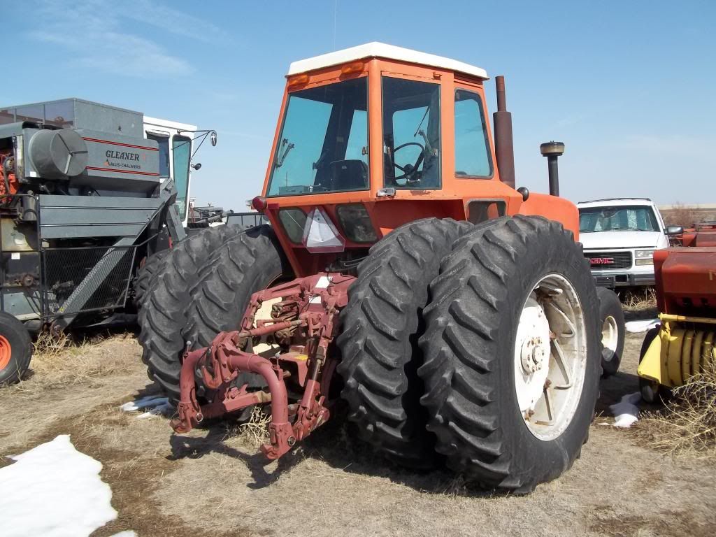

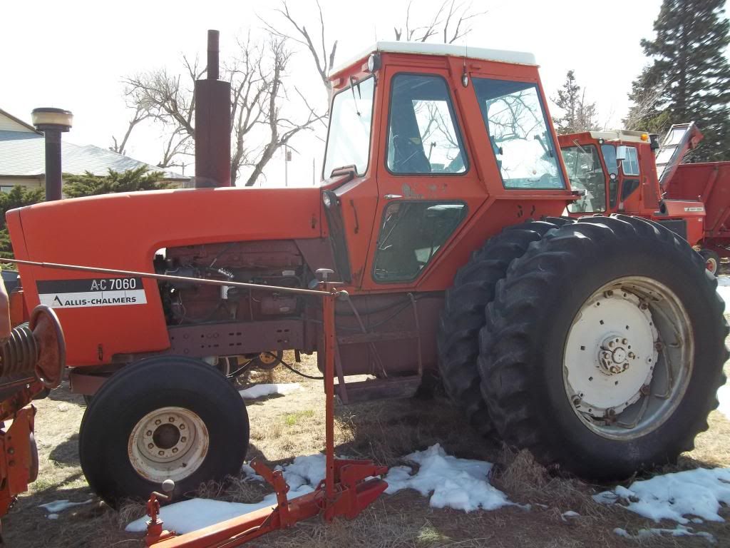

this is the tractor in question
long axle, cast center duals, 18.4R38 on power adjust on all 4, 11.00-16 fronts. single battery tray, 3 remotes (2 fact. 1 dealer installed) 2 speaker radio, factory Allis quick hitch and factory top link with handle, and double clevis.
a/c almost doesnt work, and seat squeaks with each bump, so not a pleasure to run, but still more enjoyable than a deere. :)
