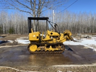

Hello there, having an intermittent issue with track power loss on my hd4. It will push like a SOB until it’s spinning the tracks and then some times it will push into a bank and act like it’s in neutral or not fully engaged. Same with reverse, it will climb a tree backwards and then all the sudden it won’t pull a sick whore off a piss pot. I noticed messing with the shuttle shifter I can make it work, some of the time.. could it be something in there that would make this happen? (Fingers crossed)
Hot check on the stick was good, fluid color and smell is good, brand new can filter on front of machine. Did not clean suction screen. I just got the machine a couple months ago, only ran it a little bit then as I had to rebuild front idler bushings/shafts and carrier rollers. Any info is appreciated!
