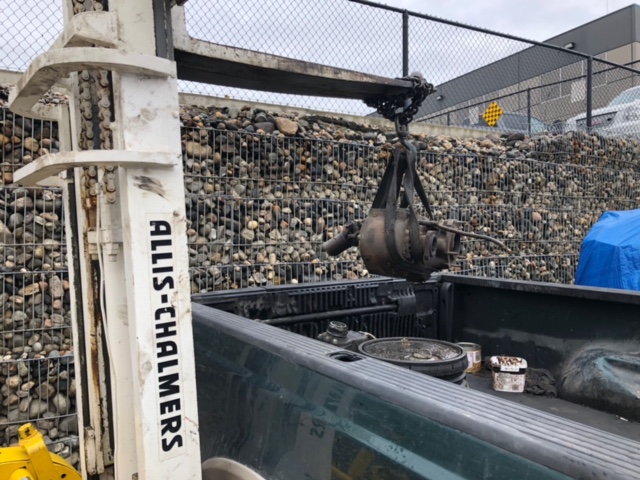

I restored my old Allis back to running condition just over 5 years ago.  Has the Buda D175 which was really abused and in bad shape.  Having said that, it now has 250 hrs on it since it's been back in service and never run better.  I decided to swap it out a few years ago with a Deere or Detroit.  Found an old 1958 Detroit 2-53 and rebuilt that to replace the Buda.  The day has finally come to swap out the Buda for the Detroit.  I'll post videos for those of you that are interested.:)
1965 AC FDX40-24

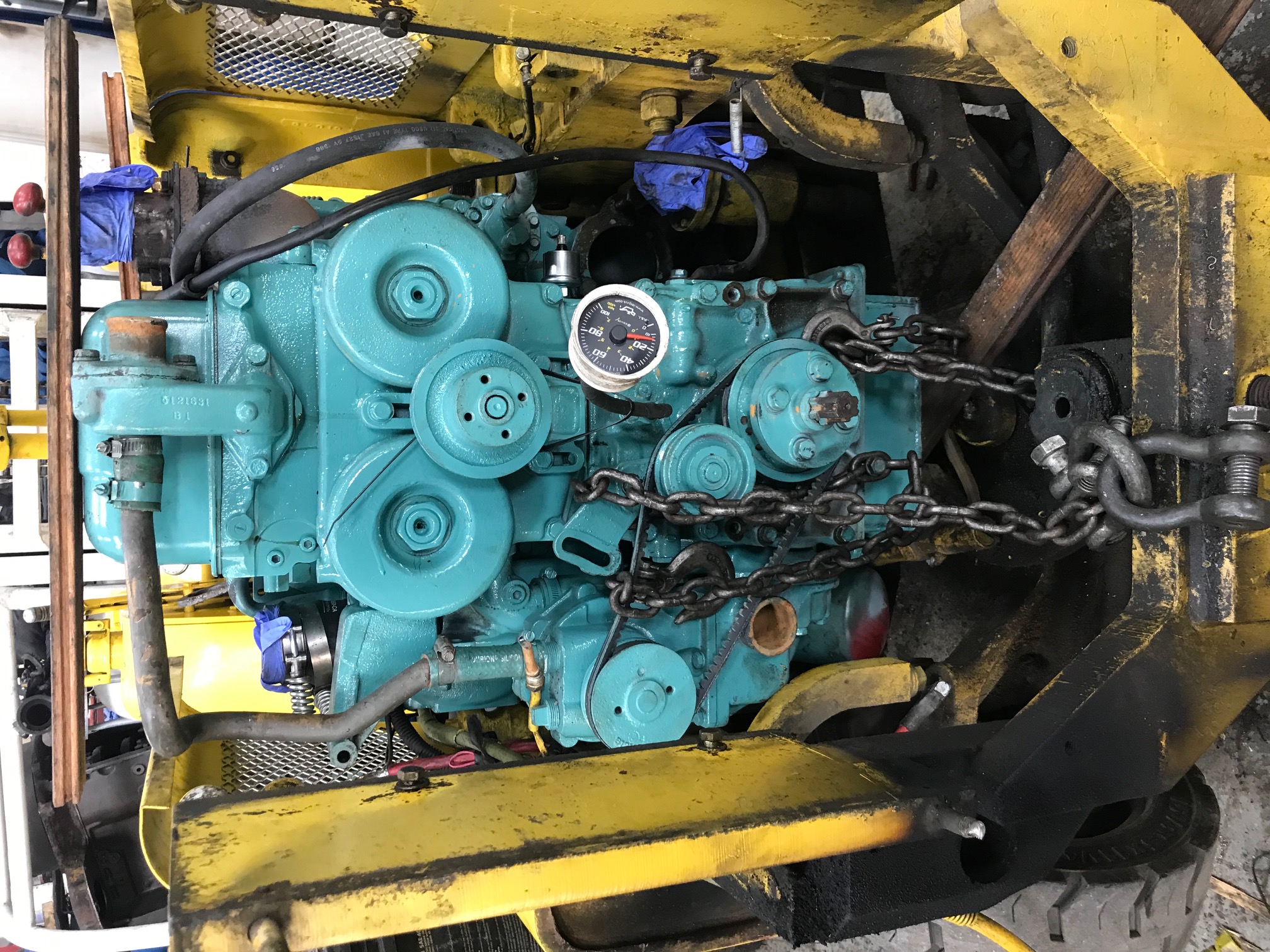

Test fitting the 2-53 into Allis.  It's a tight fit, but fit's pretty nice.  The Detroit is 31" compared to 26" for the Buda.
1965 AC FDX40-24

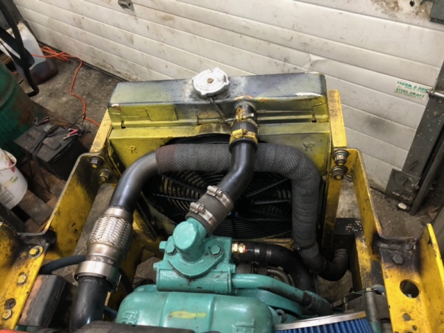

Some more progress on the Detroit 2-53 swap.:)  I've got the engine mounted and started in the Allis for the first time.  Just finished up the flywheel last weekend, I joined the Buda and Detroit flywheels together and works perfect.  Now working on the hydraulic pump while the flywheel is off getting balanced.:)  On the home stretch now.:)https://www.youtube.com/watch?v=t-jZSlnuZCE
1965 AC FDX40-24

Post Options Post Options   Thanks (0) Thanks(0)   Quote DiyDave Quote  Post ReplyReply Direct Link To This Post Posted: 20 Oct 2023 at 8:19pm
Maybe its a trick of perspective, but that muffler looks mighty close to where I assume you sit.
A310 View Drop Down
Joined: 30 Nov 2017
Location: Kelowna, Canada
Points: 105
Post Options Post Options   Thanks (0) Thanks(0)   Quote A310 Quote  Post ReplyReply Direct Link To This Post Posted: 20 Oct 2023 at 8:34pm
It sure is.:)  This is for testing only, the final intake and exhaust will be rerouted so the seat can be used.:)

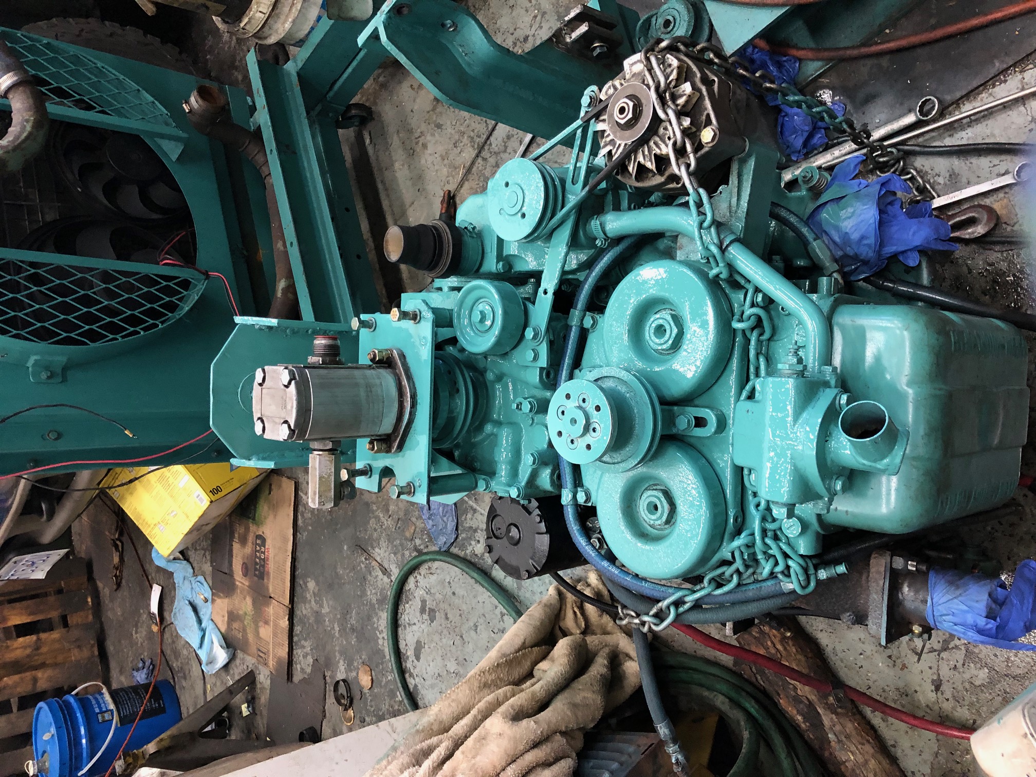

The hydraulic pump mounts finished, so the 2-53 can go back into Allis for the last time.:)
1965 AC FDX40-24
