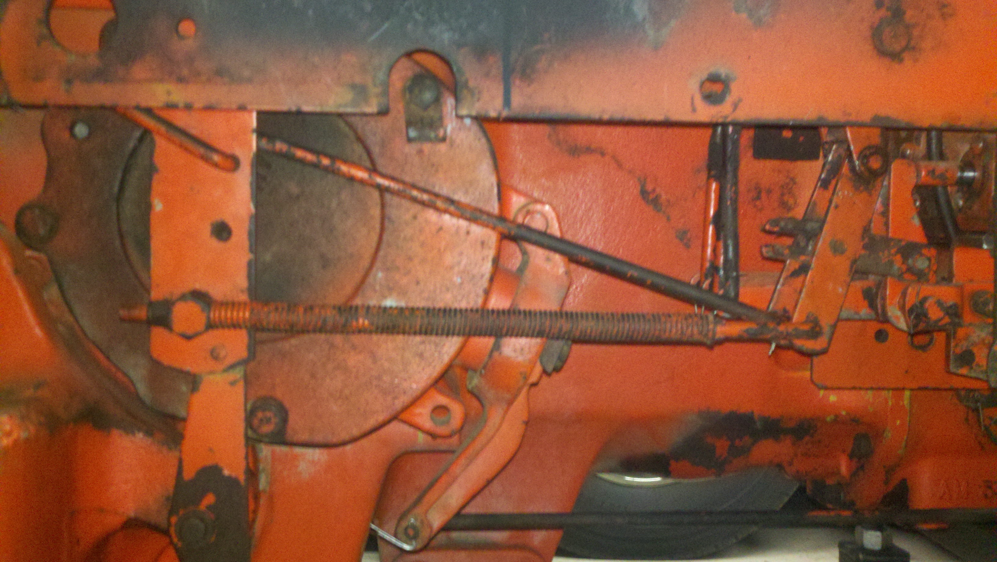

Been working on my 190 all winter, rebuilding Power Director, swapped out the original trans and rear end for a series lll in good condition. Put the platform back on and control consol. My question is, (should have taken pictures) how exactly does all the linkage for the position control from the 3 point, to the remotes all hook up, took pictures of some of the linkage, but not what i need to make sure its right. Could someone post a pic of there early 190's position control linkage. I can post pics to if that helps.
Thanks much, Carl.

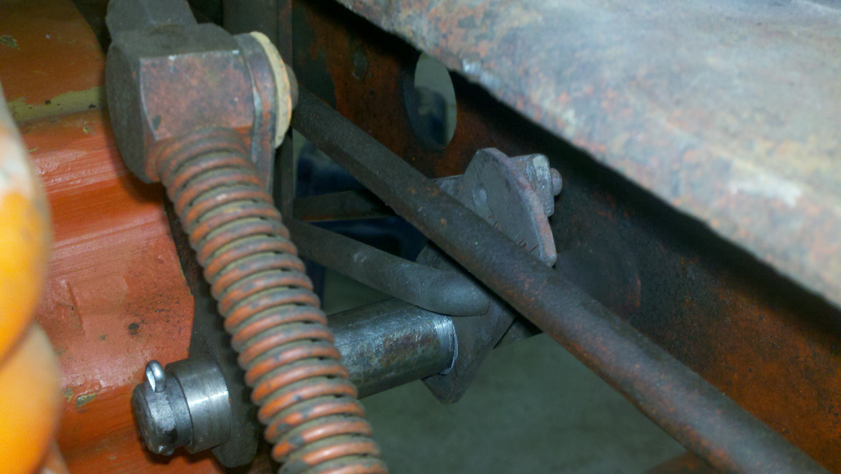

Carl(NWWI) View Drop Down
Location: NW WI
Points: 955
Post Options Post Options   Thanks (0) Thanks(0)   Quote Carl(NWWI) Quote  Post ReplyReply Direct Link To This Post Posted: 26 Feb 2012 at 2:43pm
Heres my question now, i believe the linkage is all hooked up right, but, in the first picture there are them two levers on the pipe, the pipe was locked up on the shaft, and levers fell off when beating the heck out of it to get it off, so I made a new peice of pipe and slid the levers on it, I need to weld the levers in place, what is the proper place the levers need to be positioned? According to diagrams the feed back lever (2nd pic) needs to be leaning forward. Is that correct?

When I get home tonight I will try to get some pictures of what you need off of my 190XT, it is a series 3 but I think those levers are the same.

Post Options Post Options   Thanks (0) Thanks(0)   Quote stray Quote  Post ReplyReply Direct Link To This Post Posted: 28 Feb 2012 at 5:19pm
I hope these help the postion control lever is all the way down and and the lift arms are all the way down.  If you need anything else let me know and I will try to help, but there are others on this site that know these tractors alot better than me.
1969 190XT series 3

I just found it way easier to do everything with platform off. Plus the linkages were all froze up. The pictures help a ton! Thank you!

Post Options Post Options   Thanks (0) Thanks(0)   Quote Travis(NE) Quote  Post ReplyReply Direct Link To This Post Posted: 28 Feb 2012 at 6:16pm
Here are a few pics I took of my parts 190 I have sitting in the back. The rear tires are off and it was still a PIA to get pictures of the linkage, so I could only imagine how difficult it would be with a tire in the way. Also noticed that the last person to work on it did not hook any of the linkage back up, so not sure the pictures will help.
While you were patiently waiting for someone to post pictures did you try looking in a parts book, workshop or operators manual? agcopartsbooks.com has a decent picture and even my cheap I&T manual shows a picture that would get you very close. These are just a few of the other places I would have looked for information. After reading the adjustment procedure you may want to only tack weld the arms about 90 degrees apart from each other and then make sure you can get it adjusted before fully welding anything.
As Mack and even the I&T manual describes it is not neccesary to remove the platform, just lift and support it out of the way to roll the rear end out. Granted your work area may not have allowed for that? These are just a few of the things you will and can only learn with experience.
Best of luck to you and let us know how it goes or if you need any additonal help.

Alright! We are golden now! The pictures defintilty helped! Thanks everyone! Sorry I blew up too, it happens from time to time, we are never perfect! Haha

Yup that is about the same picture I seen in the operators and repair manuals. There is also an adjustment procedure that is in the manuals also.

Its all good Travis. I do have a manual and I did look, which helped me get the linkage hooked up right, but it still didn't answer my questions about the levers 100%. I also found tonight the handles need to be all the way down for everything to sit right. So now I need to weld the levers in place on the pipe and adjust the linkage according to book. Hopefully all goes well.
Thanks, Carl
