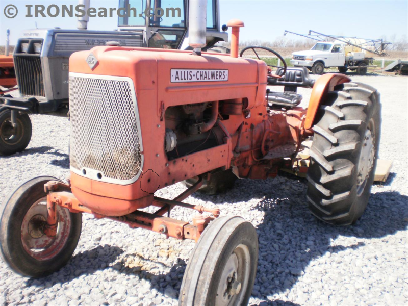

Post Options Post Options   Thanks (0) Thanks(0)   Quote Charlie175 Quote  Post ReplyReply Direct Link To This Post Posted: 06 Jul 2011 at 5:52am
Not my tractor but I circled the hole in question
Charlie

Post Options Post Options   Thanks (0) Thanks(0)   Quote BobHnwO Quote  Post ReplyReply Direct Link To This Post Posted: 06 Jul 2011 at 7:27am
My 58 D17 has 1/2" bolt on each side,goes thru the cowl,does not go all the way into the reservoir.

Post Options Post Options   Thanks (0) Thanks(0)   Quote Charlie175 Quote  Post ReplyReply Direct Link To This Post Posted: 06 Jul 2011 at 8:13am
I wonder if someone screwed it in to far and broke the casting out? I will just plug it then.
