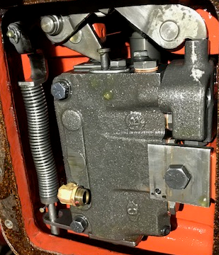

The traction booster linkage, the linkeage finger closest to the bottom on the pan is binding on what appears to be a he head boot, the inner finger for the traction booster I'm assuming is suppose to press into the 1/2" or so horizontal slit in the hydraulic pump when the traction booster lever is at the bottom of the quadrant? |

Valve stem looks fine and linkage is pressing on it. The traction booster linkage, the linkeage finger closest to the bottom on the pan is binding on what appears to be a hex head boot, the inner finger for the traction booster I'm assuming is suppose to press into the 1/2" or so horizontal slit in the hydraulic pump when the traction booster lever is at the bottom of the quadrant?

Can you put the Boost lever all the way down, look at where the lever would be if it worked and then just use something to move it into that position?
DrAllis ![]() Orange Level Access ![]() Joined: 12 Sep 2009 Points: 21978 |
The picture doesn't show the hold valve.

Here is my D17 series 1:

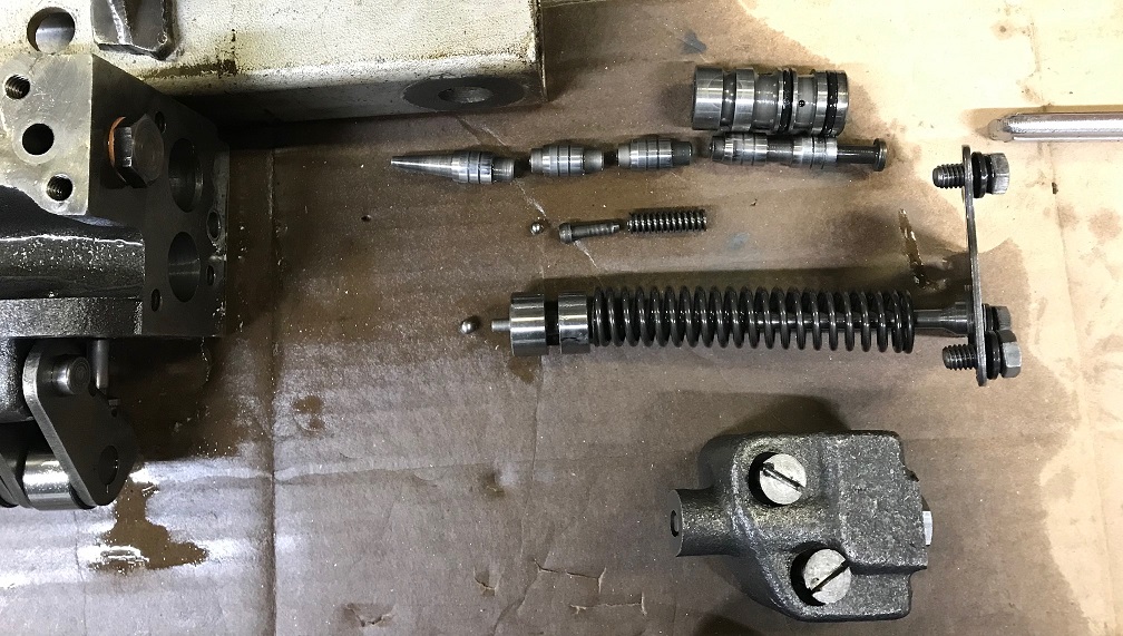

The part the traction booster linkage finger would push in must be seized or binded in on mine because mine is not extended like yours is in your picture. It doesn't matter where I have the traction booster lever on mine, so I'll see what some penetrating oil will do, if nothing I drop my pump and take a look internally. |
ACthunder ![]() Silver Level ![]() Joined: 07 Oct 2009 Location: Wentzville, MO Points: 79 |
Here is a pic of my D17 Series 1 (below 10,000 sn) that I just took apart to replace the seals:

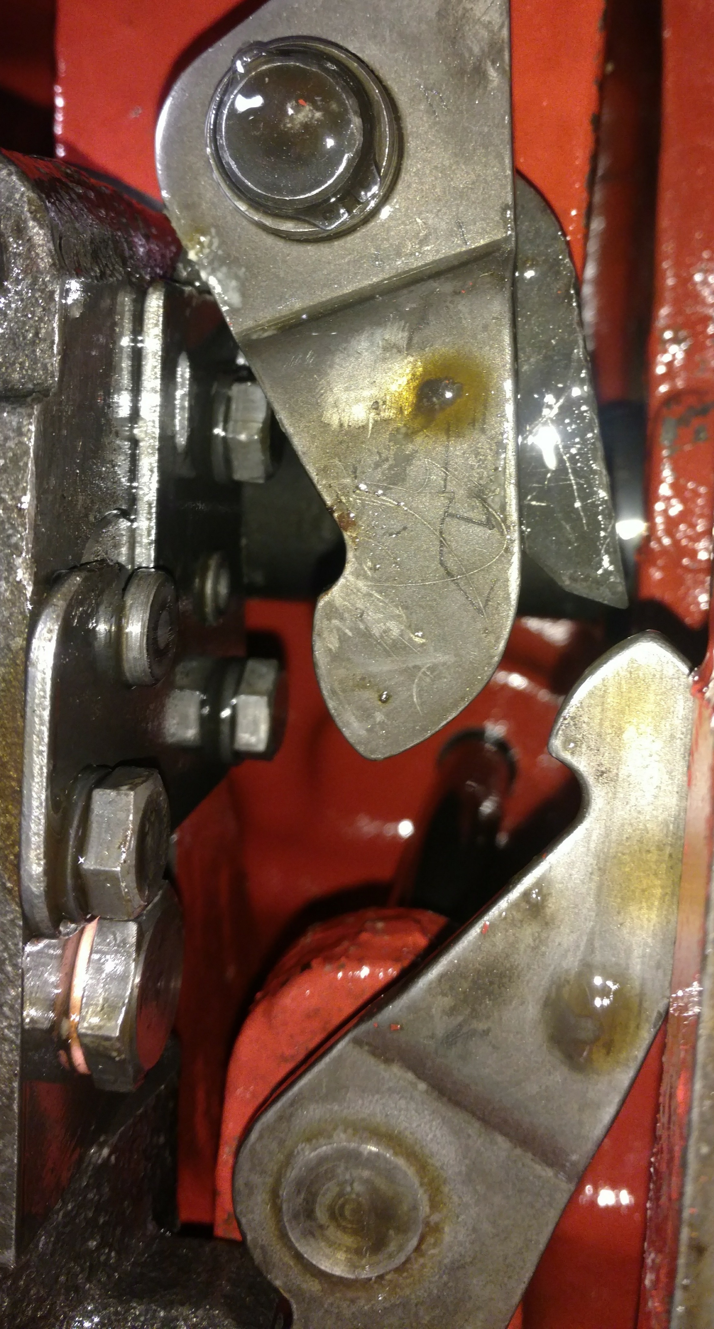

![]() ![]() Any thoughts on how the linkage finger for traction booster will go past that plunger? When I put my traction lever to the bottom of the quadrant it binds against that plunger causing my lift arms to stay raised. |
