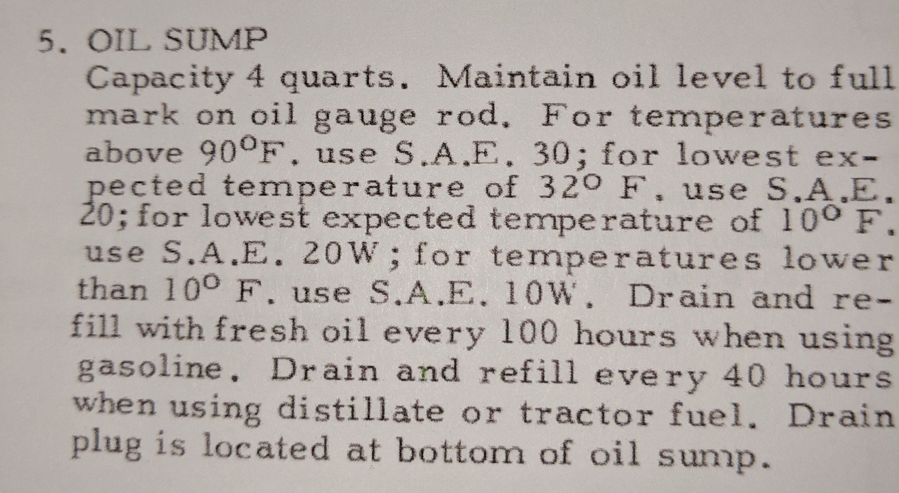

Post Options Post Options   Thanks (0) Thanks(0)   Quote Hunt4Allis Quote  Post ReplyReply Direct Link To This Post Posted: 11 Jul 2019 at 1:13am
I did find this in the lubrication and service guide...

Post Options Post Options   Thanks (0) Thanks(0)   Quote Hunt4Allis Quote  Post ReplyReply Direct Link To This Post Posted: 11 Jul 2019 at 1:15am
So what Ill be best to use is SAE 20 correct?

Post Options Post Options   Thanks (0) Thanks(0)   Quote WF owner Quote  Post ReplyReply Direct Link To This Post Posted: 11 Jul 2019 at 4:37am
When these tractors were built, straight weight oils were the norm. Multi-viscosity oils are better suited for a wide range of temperatures, like the extreme heat you are experiencing right now.

Post Options Post Options   Thanks (0) Thanks(0)   Quote Hunt4Allis Quote  Post ReplyReply Direct Link To This Post Posted: 11 Jul 2019 at 5:38am
So 5w-20 or 30 be better?

Post Options Post Options   Thanks (0) Thanks(0)   Quote WF owner Quote  Post ReplyReply Direct Link To This Post Posted: 11 Jul 2019 at 5:45am
Since AC says 10W for cold weather, I would probably not go to a lighter weight than that. I, personally use 10W-30, but a lot of guys are using 10W-40 or even 15W-40. I would hesitate to use 5W, fearing it may be a little too thin to maintain oil pressure on a bypass system.

I ended up getting straight 30 weight oil that my agco recommended
