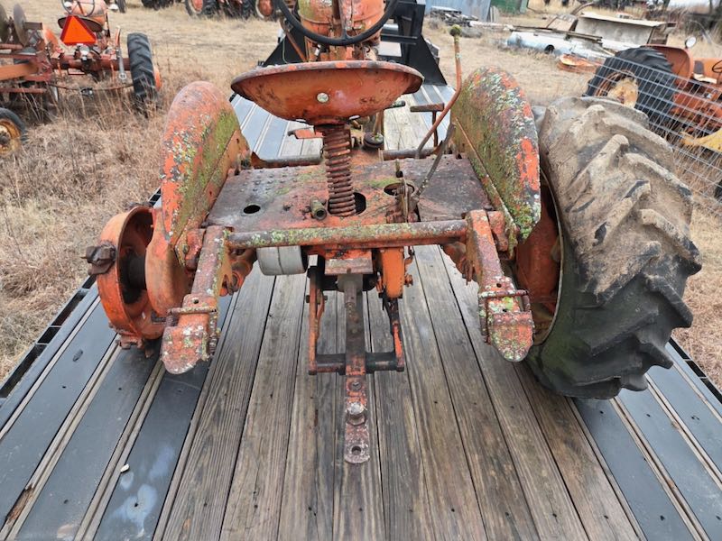

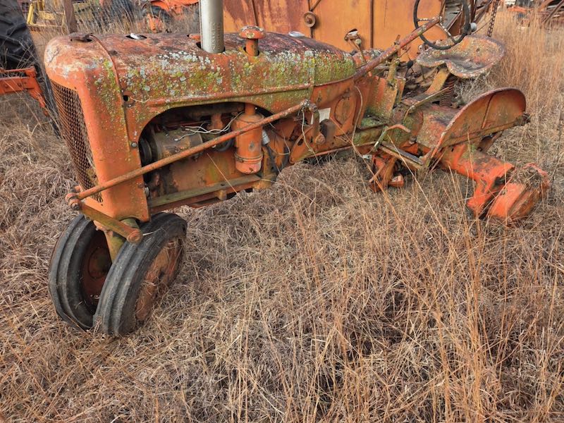

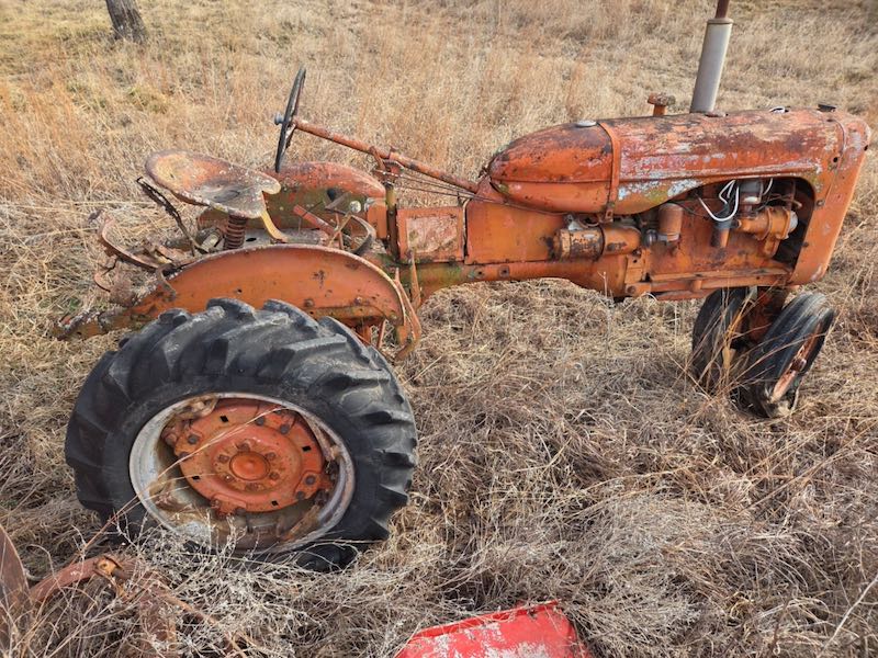

I have been keeping an eye out for Snap Coupler CA parts. All of my CA implements are pin hitch, but with the 4 row toolbar planter I am building, I'm worried a CA might not be able to handle quite that much weight based on feedback from the forum. It would be nice to set the planter toolbar up for Snap Coupler and be able to just hook that planter up to a WD/45 if I find out the CA can't handle it. Cue the search for the CA Snap Coupler hitch parts and I found this 1953 CA for sale and dragged it home.
The one rear rim disintegrated when we winched it onto my trailer. There was a can over the exhaust but it's stuck solid. I think I have gotten lucky once in my life with soaking the cylinders in diesel and actually breaking an engine loose. Might do that just for kicks while I work on the other tractors and the planter.

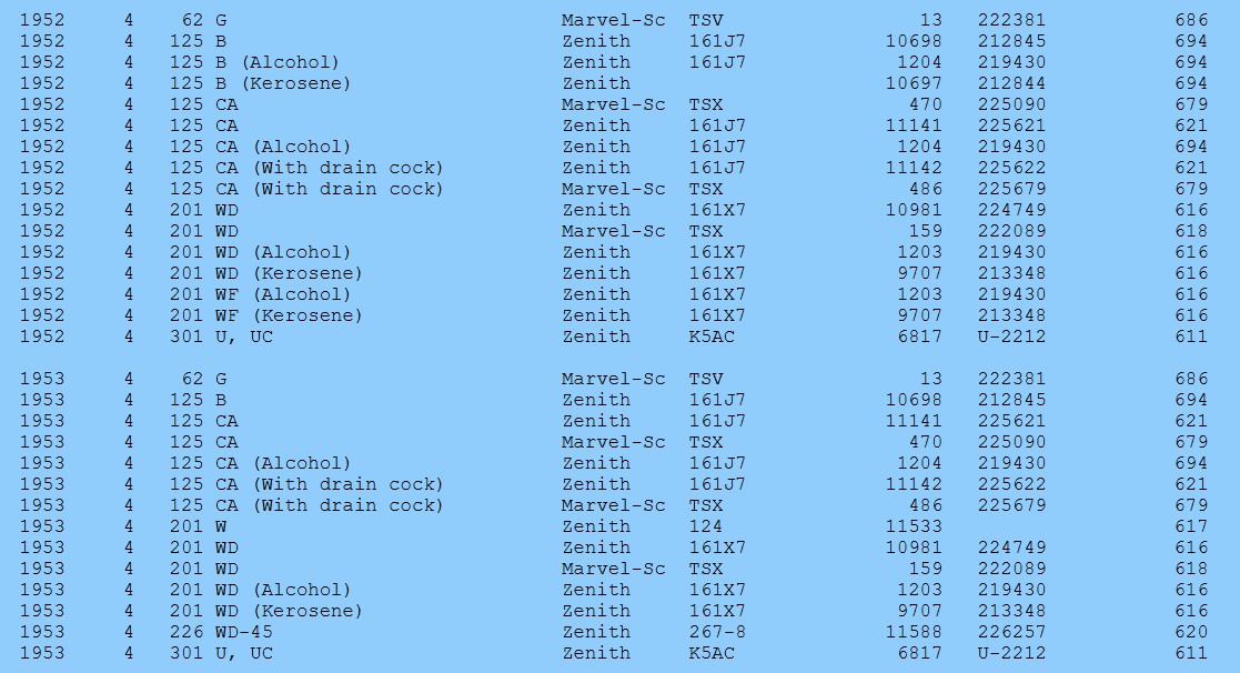

Edit: AGCO website does not seem to corroborate the kerosene theory but does not provide any indication that a kerosene engine is available (like indicated in the service manual).
Don't know that this is correct or complete but several different sources show this same data.  One site seems to indicate that Zenith 161 carbs were used primarily on low compression kerosene-capable engines and TSX on the gasoline only engines.  You could get low compression engines for a CA as an option.
Edited by dfwallis - 18 Feb 2026 at 11:53am

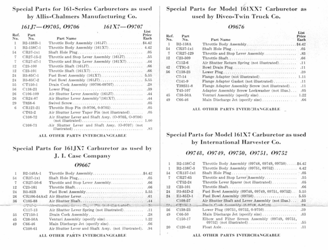

I haven't seen a single list of carb application numbers for AC tractors online that I actually trust. I can poke a ton of holes in that list at Norfar (but I have had good experiences buying parts from them). I have two TSX-670 carbs that would only fit a CA if you had a different manifold with a larger mounting flange. I am fairly certain they came off of a D-series tractor of some sort (D14 maybe?), but that's not shown in the list. There are other numbers that are clearly wrong too.
161J7 is just a sort of a high level... model number, maybe, is how to think of it? I don't believe you will find any carb that actually has 161J7 on the ID tag. It will have the 11141 or 11142 numbers on it in my experience. The spec number on the tag is what varied as built by Zenith, with specific jet sizes, vent sizes, venturi sizes, etc.
I agree.  I was having trouble with my TSX-486 and was unable to locate one.  I did locate a 670 which the interweb said was compatible but it was very obviously NOT.  I was however able to modify it by combining a TSX-486 rebuild kit and some other modifications to make it work.  It actually runs fairly well with it even though I think it is a higher CFM than the 486.  It ran horrible with a Zenith 12566 which one or two websites said was compatible but was not (ran good at idle but fuel starved in the extreme at anything above idle).  The "universal" replacement is designated as a 12522.  I've not tried that one.  But that one is a horrible/kluge fit.  The bolt patterns don't match which allows easy misalignment which causes the throttle plate to hit/stick if you aren't careful.  You can partially solve that by using two (or three) gaskets.  And then you have to cut off the throttle plate rod to keep it from hitting the block, which makes it non-returnable...I say no to crap kludges like that if at all possible.

The "161J7" is like saying "truck" as compared to "car , van , motorcycle"... just a VERSION as wjohn said...
A carburetor number of 161J7 identifies a specific Zenith 161 series updraft carburetor, commonly used on older agricultural and industrial equipment, most notably Allis-Chalmers tractors (such as models B, C, and CA) from the 1940s through the 1960s.
Here is a breakdown of what the 161J7 designation means:
  • 161 (Series): Defines the series of the Zenith carburetor. It is an updraft, single-venturi design, often used on 4-cylinder agricultural engines.
  • J (Style/Feature): Indicates the specific configuration, which is a "back-suction economizer".
  • 7 (Variation): Represents the specific modification or version of that model, which may relate to the specific fuel inlet, throttle/choke linkage, or mounting flange
Yes, understood that.  The service manual doesn't reference vendor specific PNs, only AC PNs and the Zenith "161J7" nomenclature.  Finding complete documentation (online) to accurately track what fits what tractor is I think nonexistent.  I once found a site that had lower level details/xref but I can't find anymore.
Here's an extract from an old Zenith PN/price list.  Seems to show PNs 09705 and 09706??
