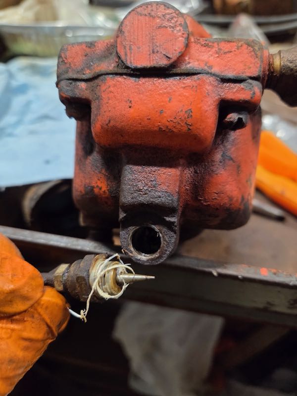

Got the carb off and the starter out. The carb had definitely had some gas dry out in it. The float was half full of gas. I think the threads for the main jet plug/adjustment needle assembly are trashed... they look stripped and there was a bunch of thread tape crammed in there that ended up everywhere. It's interesting that this carb has a main jet adjustment needle. Per the parts catalog and my other CA it should have a plug. I may need to make sure all the jets are sized properly if parts were getting swapped around. The main jet itself had no gasket on it when I removed it. I think someone probably cleaned this up for the auction just enough to get it running after it sat in the guy's collection for however long. Worst case I should have another carb bowl with good threads for the main jet plug/adjustment.

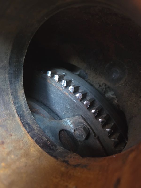

The starter pinion looks great. The ring gear... not so much. I am actually wondering if this tractor was never converted to 12V and someone slapped a new 12V battery in it before the auction. Will need to dig into the electrical more later to see if that's why the starter is slamming it so hard, and replace that ring gear or stick with hand cranking for a while.

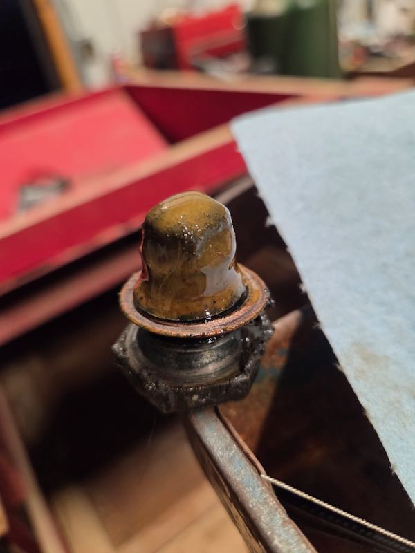

I drained some very thick looking oil out of the trans/rear end. I did not get any chunks or pieces of metal though. The magnetic drain plug in the PTO/hyd pump housing had filings on it about in line with what I've seen on my WD/WD45s. If I have time tomorrow I'll pull more apart.
