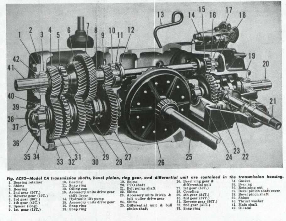

your right john.. when in neutral it should not try to move.. I was thinking with the clutch pushed IN while in gear..... When the clutch is engaged and trans is in neutral, the TOP SHAFT is spinning, but should not have any gears engaged..  Maybe slop or bad detent in the shift lever ??  Dont see how a TRANS bad bearing would do it..... does the PTO work OK without noise ? ... does having the PTO engaged have any effect of the "try to move" ?
what im wondering is if there is a problem with a bearing or ?? in the PTO ...the lever should be disengagning it from the spinning top shaft.

What kinda lube is in it? I'd say it's just drag from gears on shafts trying to turn pinion.
