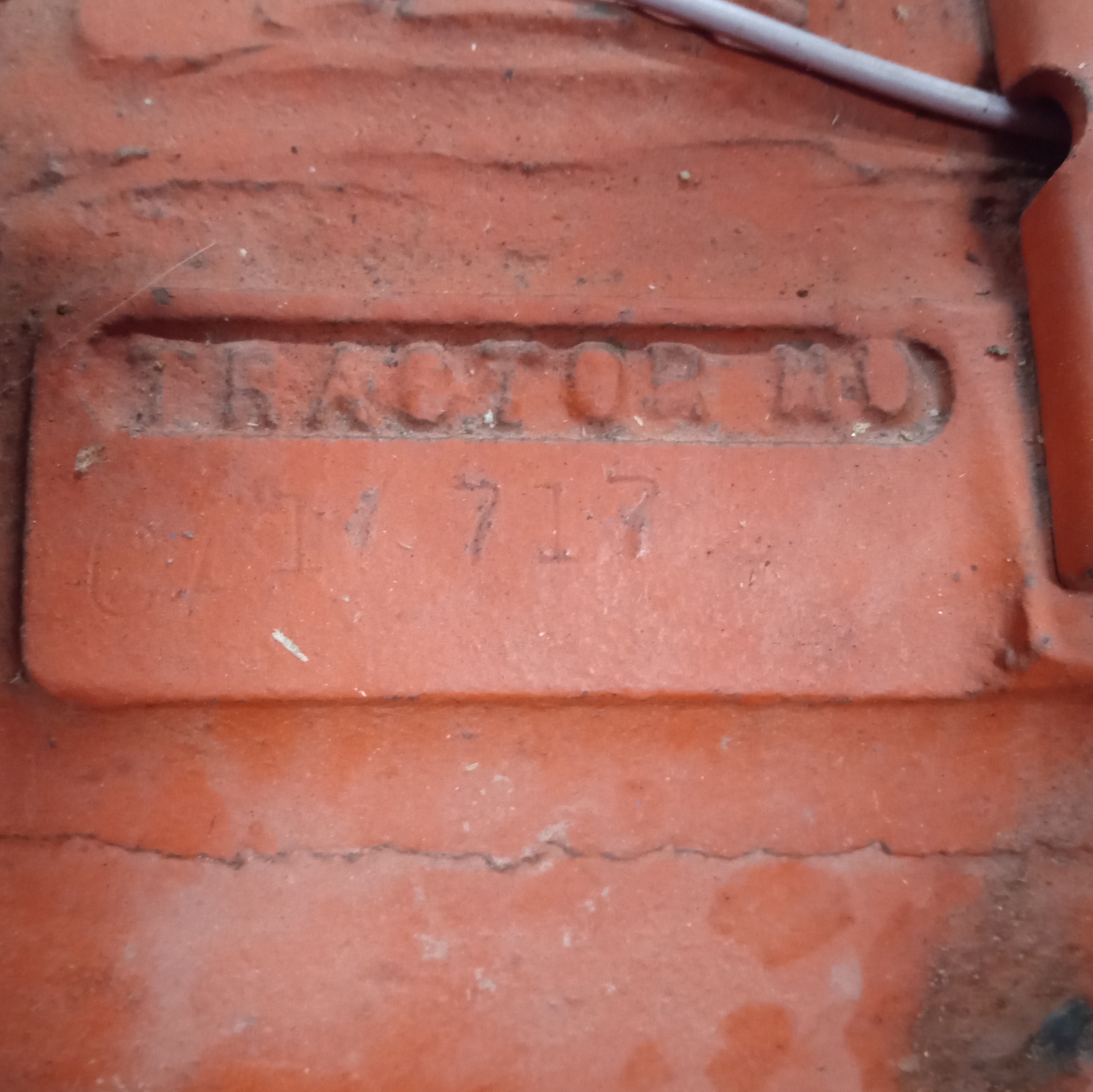

Serial number of my CA.
1953 WD45 WF/Model 90 Loader, Oxnard Rear Blade, 80R Mower, Model 209 Disc, WD Rear Mounted Scoop, Model 184 & 160 Rotary Mowers, 1952 CA NF/L306CA mower, 1953 CA WF/Model 8 Loader.
So the rest of the forum isn't confused, ha - we had a PM conversation and it turns out we have CAs that are consecutive serial numbers. This tractor is CA17716.

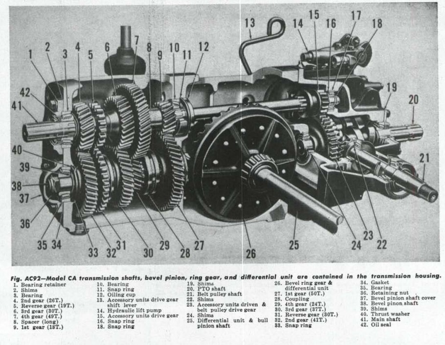

Yup. The CA has constant-mesh gears and you do not have a lot of leverage turning the PTO by hand with all of those gears swimming in that cold gear oil.
I am curious as to what you find inside because the belt pulley most certainly should be geared to the PTO shaft.

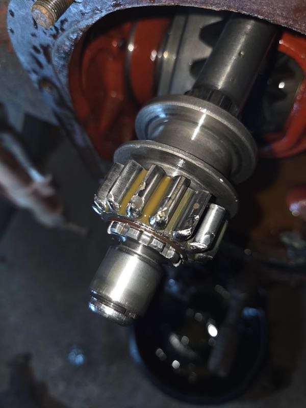

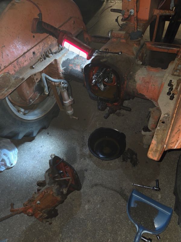

Got the carb off and the starter out. The carb had definitely had some gas dry out in it. The float was half full of gas. I think the threads for the main jet plug/adjustment needle assembly are trashed... they look stripped and there was a bunch of thread tape crammed in there that ended up everywhere. It's interesting that this carb has a main jet adjustment needle. Per the parts catalog and my other CA it should have a plug. I may need to make sure all the jets are sized properly if parts were getting swapped around. The main jet itself had no gasket on it when I removed it. I think someone probably cleaned this up for the auction just enough to get it running after it sat in the guy's collection for however long. Worst case I should have another carb bowl with good threads for the main jet plug/adjustment.
The starter pinion looks great. The ring gear... not so much. I am actually wondering if this tractor was never converted to 12V and someone slapped a new 12V battery in it before the auction. Will need to dig into the electrical more later to see if that's why the starter is slamming it so hard, and replace that ring gear or stick with hand cranking for a while.
I drained some very thick looking oil out of the trans/rear end. I did not get any chunks or pieces of metal though. The magnetic drain plug in the PTO/hyd pump housing had filings on it about in line with what I've seen on my WD/WD45s. If I have time tomorrow I'll pull more apart.

most tractors converted to 12v just had a battery change.. They are still using the original  6v starter and ring gears... I have several that way..
Gear lube in not your friend in the transmission / bevel gear / hydraulic system..

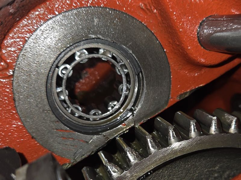

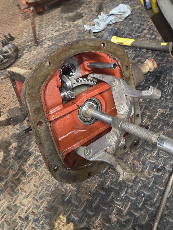

I got the PTO/BP/Hyd housing off today.
The sliding drive gear on the main shaft has experienced some trauma - maybe just from engaging the PTO with the clutch still engaged.
The casting is cracked around the rear bearing for the main shaft. I'm guessing a chunk of something wedged between the gear and the casting. I also wonder if the bearing race is cracked... Didn't notice that earlier, but looking at the picture it sure looks like it. I may have to tear this down.
Okay, the moment you've been waiting for, Les... The reason for the belt pulley shaft not spinning. I struggled to get this not so great picture, but the gear teeth for to drive the BP on the big double gear are gone... Someone intentionally ground them all off.

I can only figure that someone didn't like that shaft spinning when they had the PTO/hydraulics engaged, or more likely they trashed it somehow and went in and cleaned what remained of the teeth off. I suppose a belly mower hitting something solid could maybe do damage to those gear teeth? You'd hope a belt would slip, but that's all I can figure. There is no pulley on the shaft so maybe someone had a belly mower and v-belt pulley on there once upon a time. There was a C at the same auction that did have a v-belt mower pulley on that shaft.
I plan on planting and cultivating with this tractor so the belt pulley doesn't matter to me. I might do some PTO work with it eventually since I do have a sickle mower for it. I definitely need the hydraulic pump to work. I am tempted to replace whatever bearings are needed, clean up any high spots on the damaged gear teeth, and put it back together. My other option would be to steal parts out of one of my other 3 CAs (all currently non-running).

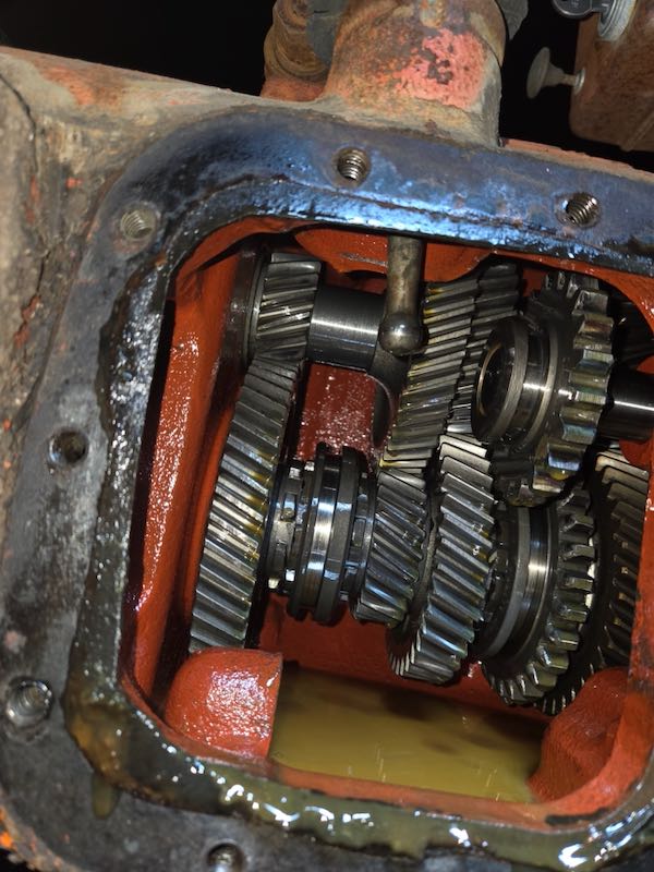

I am going to pull the side cover off the transmission next. Turning the mainshaft by hand still causes the wheels to move more than I think it should even with the gear oil drained.

Okay, the moment you've been waiting for, Les... The reason for the belt pulley shaft not spinning. I struggled to get this not so great picture, but the gear teeth for to drive the BP on the big double gear are gone... Someone intentionally ground them all off...
Whee! Reckon that will do it fer sure Big smileTongueLOL

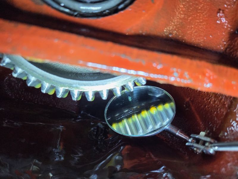

No obvious nasty surprises inside the transmission tonight, at least at first glance. The wind picked up and my fingers got cold so I called it a night. Hopefully you guys are right and the thick gear oil is just causing things to stick together a bit. I'll try to make sure when it warms back up.

Taking the PTO/hyd/belt pulley housing apart to replace bearings is going to be fun. I am wondering if the key for that driven gear got tweaked whenever whatever disaster happened. Haven't tried heat yet so that will be next to try to get the gear pressed off of the PTO shaft.
The retaining rings for the bearings also have me stymied for now. One end appears to be cut at a back angle to not give you any purchase, and both rings are like this for the two different bearings so it seems to have been by design. What's everyone's favorite trick for getting these out? I can try driving a pick or maybe a small chisel under the one in my picture, but the lower bearing snap ring is pretty beefy. I prefer the newer-style ones that have more of a gap/ledge to pry under with a pry bar or screwdriver.
The chunk out of the casting is just a small piece I plan on removing so it doesn't come loose later. I don't think it's big enough to hurt anything by being missing.

There were enough parts not available from my dealer, and that PTO driven gear did not want to come off, so I am changing plans in the interest of preserving things and saving some time. I will just clean this up and slap it back together.
There had been a lot of end play in the PTO shaft before I took it apart, but it had a good stack of shims under the end cap. With all of the shims gone I was able to take all the play out, so I can set it to somewhere in between and get it in spec. The bearings must not be that worn out so I am going to hope they last for a few more decades.
