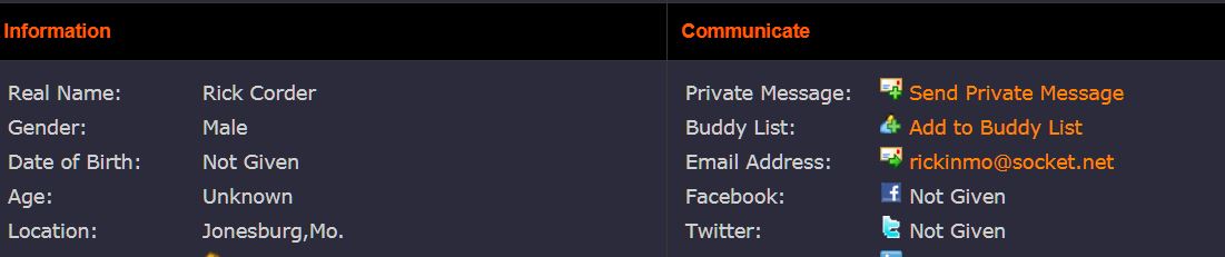

You are the second person who has mentioned Rick from Missouri. Have not been able to get his info. He is infamous. Thank you
