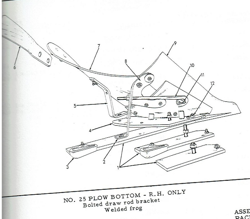

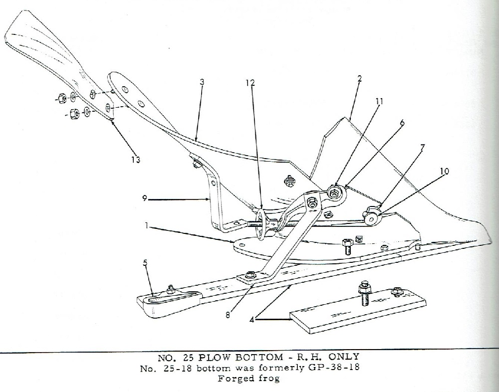

Does any one have a diagram of the bottom side of the plow where the plow share  bolts on? I took mine off last  year  and  can't  remember  how it went on .Thanks.  I checked plow parts  section .Thanks Again.

What bottom series do you have? The attaching parts can be different between different series of bottoms. However most old style bottoms just have a hook that pulls the share in place a bolt to hold it to the frog.

Size means nothing. Need a part number from some part of the bottom assembly or a good clear close up to identify what series bottom you have.

25 16 CR  GX  87  but wear does the trended end hook to. There is a piece broke off the furrow  wheel. Is that were  the threaded end bolts to?

That share number looks to be an aftermarket number instead of an Allis Chalmers part number. However I'm guessing you have a #25 series bottom. Even so there are 2 different assemblies. To get a correct answer the proper question is needed.
