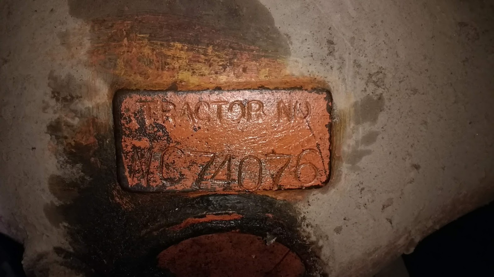

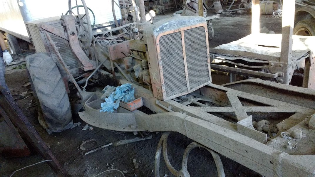

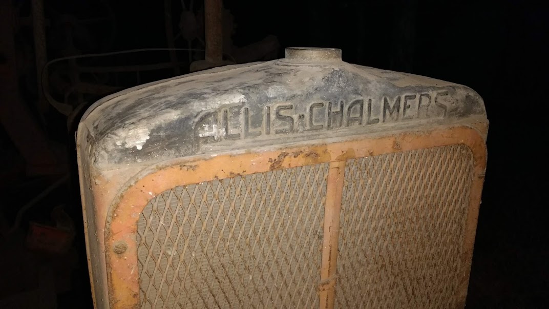

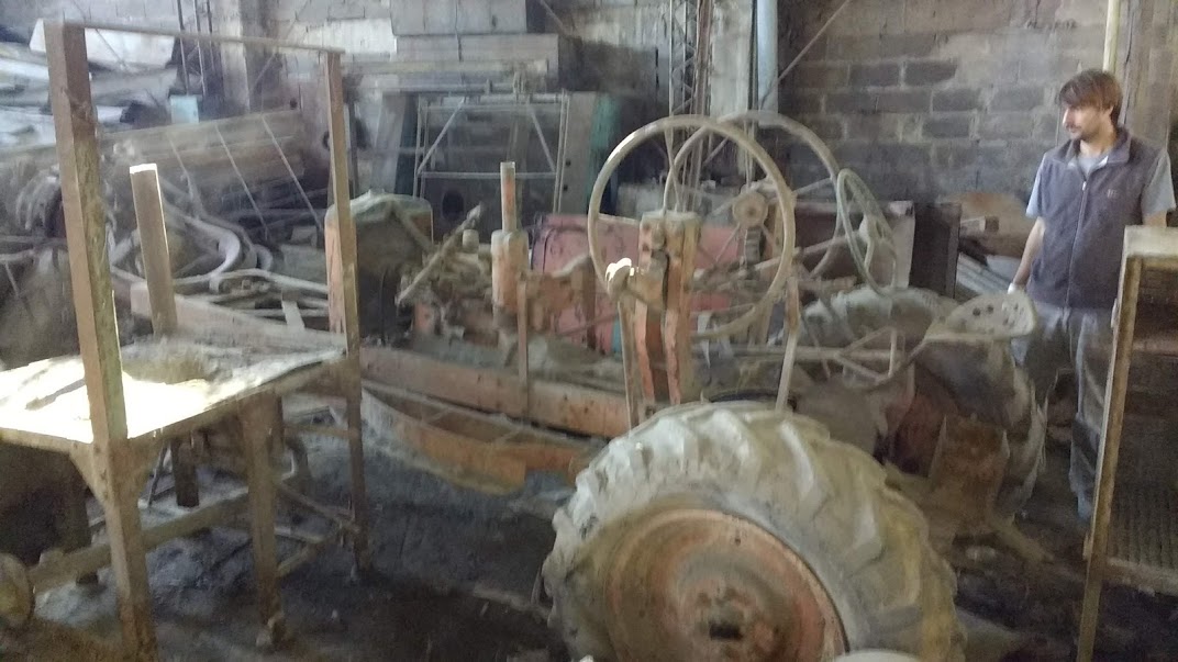

Hello everyone! I'm Alan, from Argentina. I've bought an Allis Chalmers Grader yesterday, and i'm wanting to "restore" it to take it back to life. I don't know much about it, cause i didn't have time to read the original plates to see the year of manufacturing and model of it. I took some pictures, so if any of you can give me some advice or info about it, i would be very gratefull!!
Also i'm afraid that some part is missing in the Wayco distributor, does anyone has a photo of a similar one?? i've been looking in the internet but i can't find the same one...

Built on wc tractor chassis.  If the rear wheels are original i would say early 1938 as it is the unstyled version.  Did you mean  WICO magneto?  unless it has a special magneto from south america  they are very common  here in the usa

You have an Unstyled WC Speed Maintainer. 411 were built in 1938 and 1939 with the majority being the styled version that also has a different and improved grader frame where it mount at the front. Someone has extended the front end. They were replaced by the extended front with a wide front axle WC Speed Patrol that is fairy common. Mine is only one of three unstyled versions that I know about

Hi Calvin!! thank you for your response!! I didn't noticed that the front end was modified until you mentioned that!!! jeje. I think i will restore it back to it's original length, i like it most...

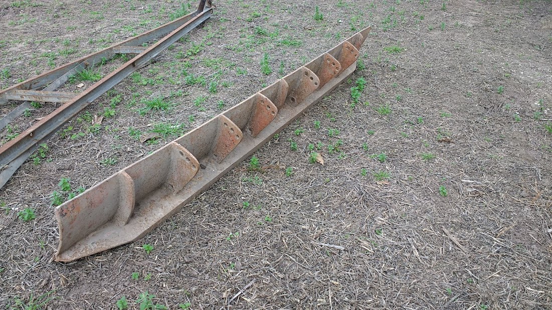

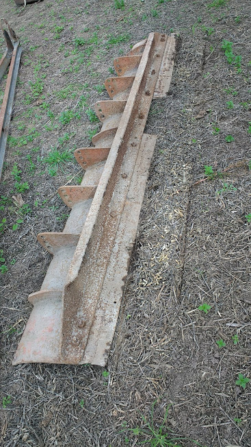

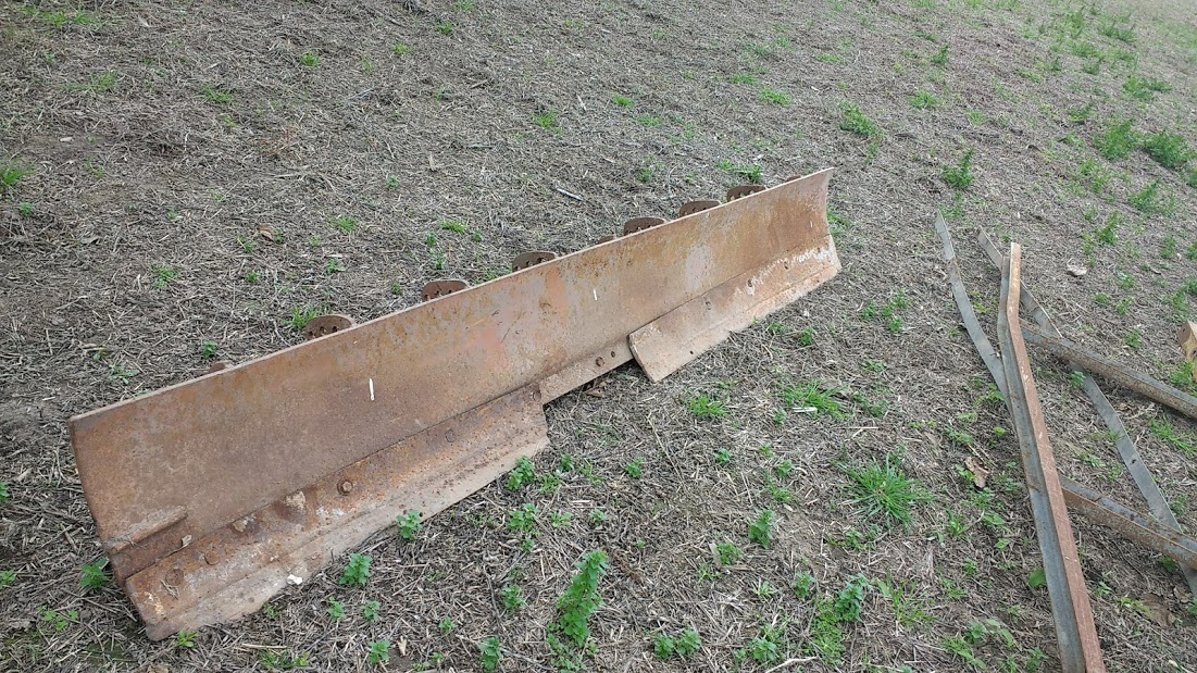

Is this grading blade original from allis chalmers? it's 3 m wide and the grabbing points seem not to be original. Was it modified?

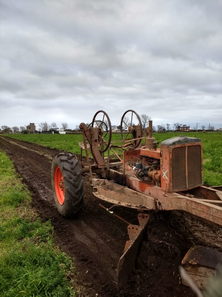

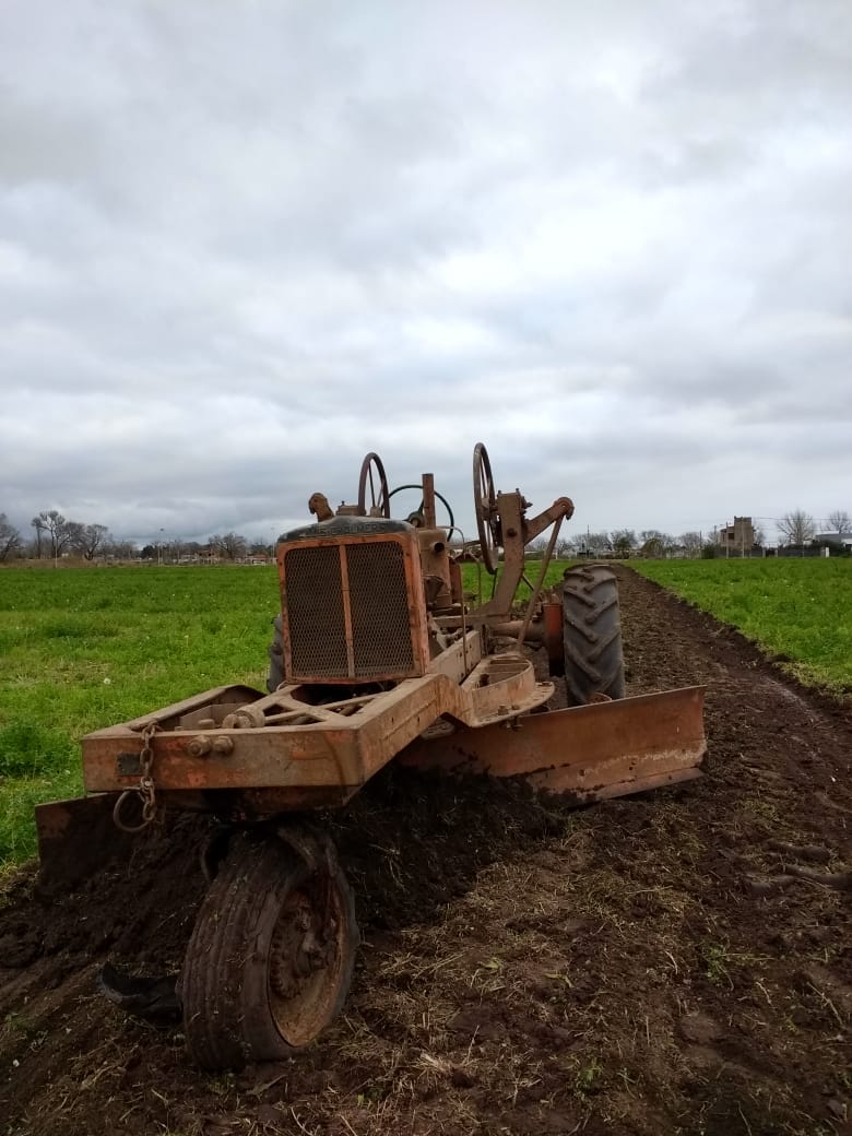

Post Options Post Options   Thanks (0) Thanks(0)   Quote Alanv8 Quote  Post ReplyReply Direct Link To This Post Posted: 29 Jul 2019 at 6:03pm

Post Options Post Options   Thanks (0) Thanks(0)   Quote NomoreJohnDeere Quote  Post ReplyReply Direct Link To This Post Posted: 29 Jul 2019 at 9:33pm
works good in that soil for sure
steer with the brakes?

Post Options Post Options   Thanks (0) Thanks(0)   Quote Alanv8 Quote  Post ReplyReply Direct Link To This Post Posted: 30 Jul 2019 at 7:27pm
Yes, really difficult to get used to operate it jeje

Post Options Post Options   Thanks (0) Thanks(0)   Quote Alanv8 Quote  Post ReplyReply Direct Link To This Post Posted: 30 Jul 2019 at 7:34pm
Given some basic attention those old Allis' just keep on working Good job Alan! Beautiful soil your pushing there too!
Thank you!!
Now i understand why did the previous owner modified the front end. Otherwise the soil would get stuck in the wheel
