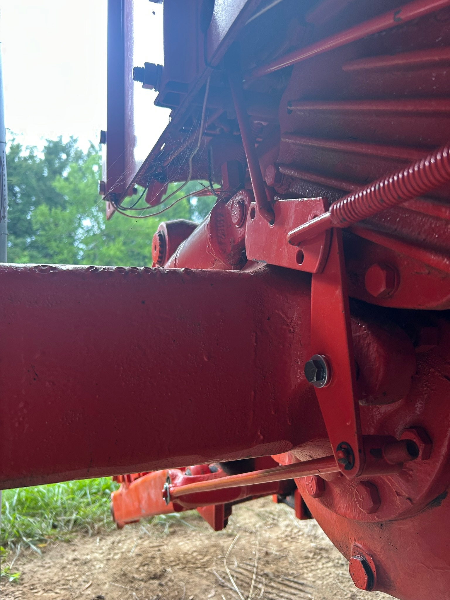

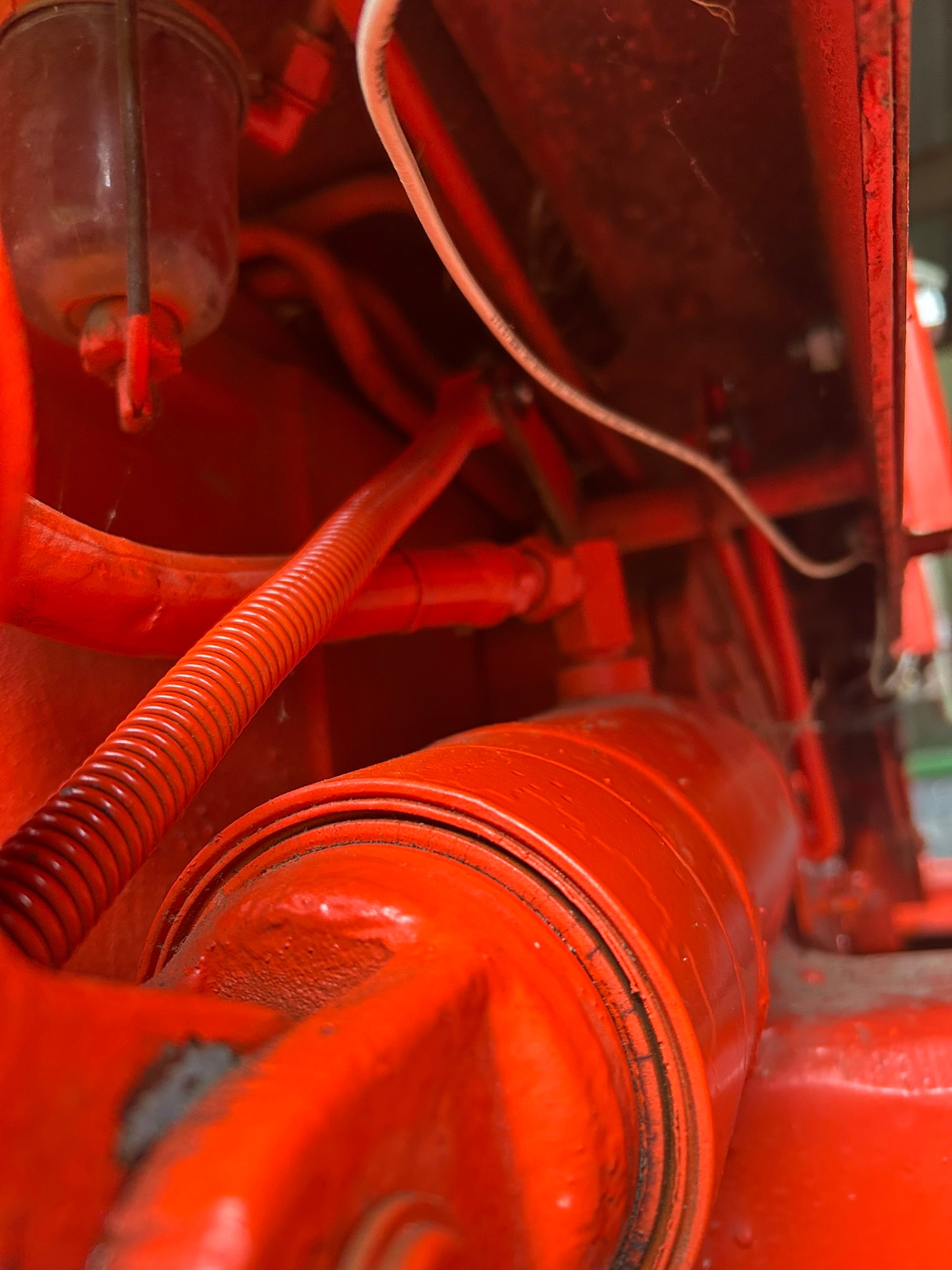

Need a little help, a picture of the linkages is what I am hoping for. My XT was missing the linkages when I bought it so I purchased the missing items and painted them along with my tractor 10 years ago. I finally got around to installing them this week and ran into an issue when I try to install the position control rod going to the lift arm. When I try to install it in the lift arm, it seams that maybe I have something wrong at the feed back lever/bell crank. Maybe in the wrong hole or I have it orientated wrong. Also, the position control rod and the control rod are different lengths so I have no idea which is which? Hoping someone will take some measurements of those 2 rods and a picture of the bell crank-feed back lever connections for me. My factory manual doesn’t give me those measurements. Thanks in advance

In the top picture, the flat piece that the two rods are attached to, needs to be flipped forward instead of backwards. I don't know if the rods are in the correct holes or not.

Once you flip that piece of linkage over, I was always taught to install a 3/8" bolt and nut in the unused top hole to stop it from ever flipping over again.

Thanks, do the rods go in the same holes after I flip it over?
