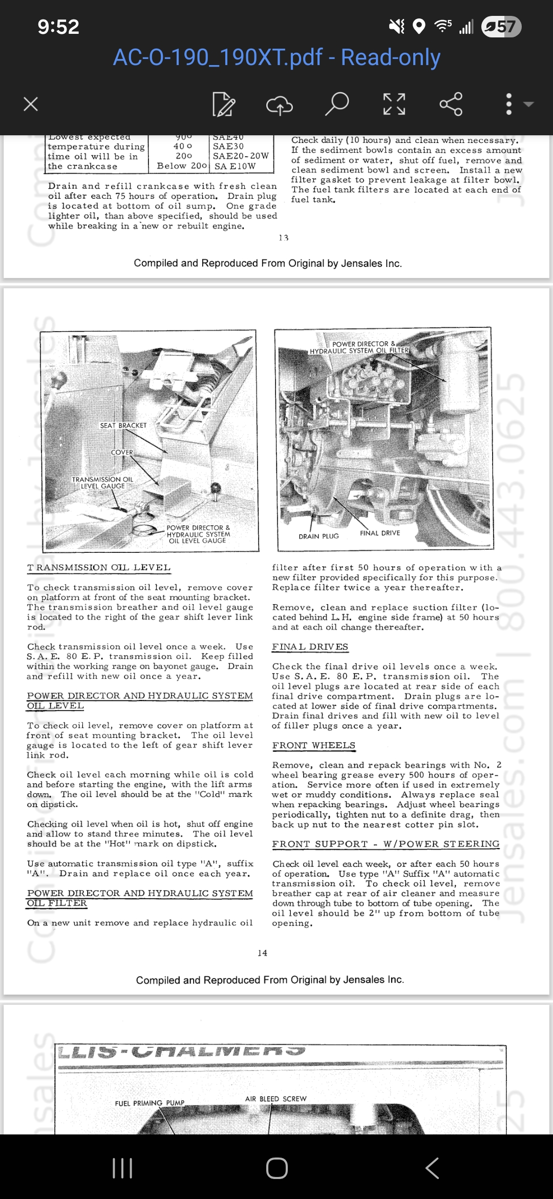

Owners manual didn't say at all where any of the actual drain plugs were and are the actual source of the confusion, also no pictures. At least the one from jensales. It says two different types of fluid and two different quantities which implies two different compartments to go with the two different dipsticks and two different drain plugs and two different service intervals.
It only shows where the final drive drain plugs is, which takes a different fluid and has a different service interval and different level checking method, is it the same compartment as the transmission and hydraulic too?

The Jensales 190 190XT operators manual 100% does not show drain plug locations for the transmission or hydraulics, it mentions there being one for each but there is no picture. It shows where the final drive drain plugs are, that's it. It shows and states two separate check/fill locations for transmission and hydraulic in the cab, does these fill the same compartment despite the manual saying they should be filled with different fluids?
