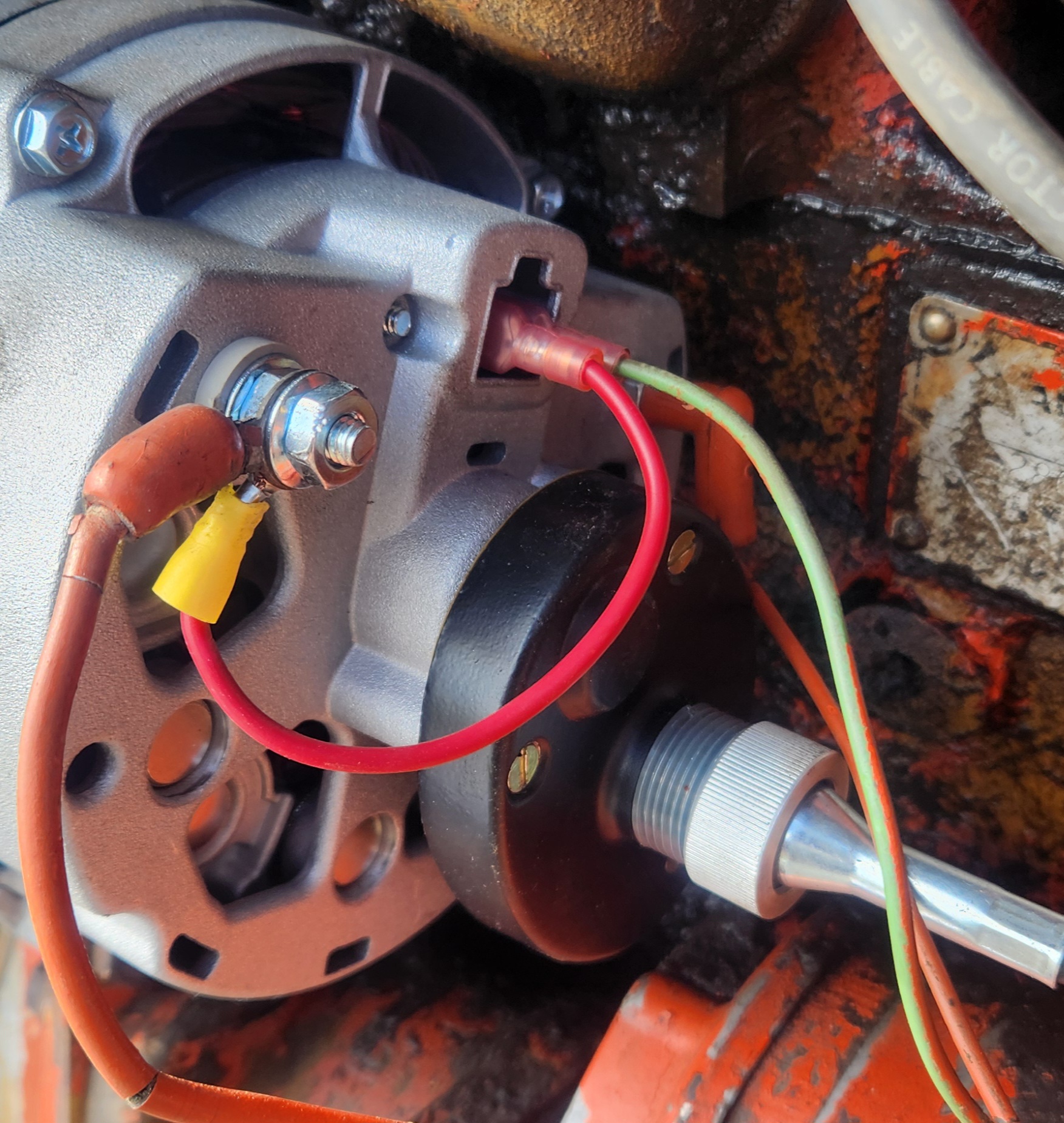

My 190xt had a new one wire alternator put on it. Since my distro tach drive is stripped I opted to go back to the alternator tach drive. Bought the old style which I guess is actually the second or new style? Whatever. Bought the 3 wire tach drive alternator from DJs. But I cannot get the alternator to charge. I'm 99% sure the wires are making solid connections on everything that is connected, and I *think* everything is wired to match the service manual. Problem is the service manual only shows for the delcotron not for an alternator?
I don't hear or see any clicking from the voltage regulator. How is this thing supposed to be wired up? How can I test the voltage regulator? The service manual read like gobbldegoock.

I think this is 3 wire. So how do I "bypass" that external reg?
I have the jumper going from power to the 'field' or regulator plug port. Should the second wire go straight to ground?
I tried all sorts of other configurations and couldn't get any charge.

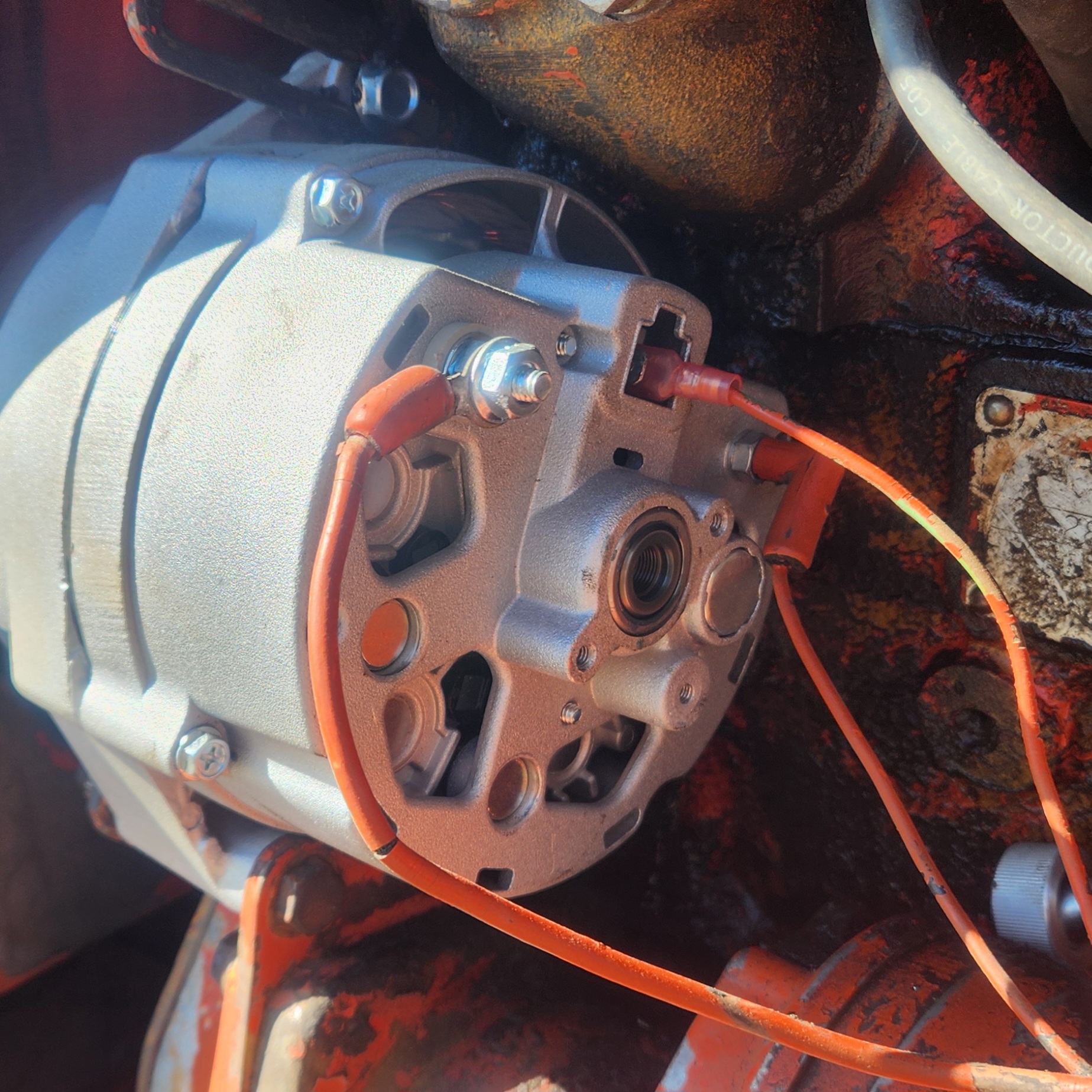

That is a Delco DN series Alternator w a mechanical tack drive. mounted to it, not sure on the regulator.
  FYI; There are 2 Voltage Regulators that work with the DN alternators.
  1 for an Idiot light. AND 1 for an Ammeter. IF wrong Reg is used the Alt won't charge.
  Left wire (orange) on Alt is live at all times and goes on that left insulated terminal.
   FYI, I'd remove the short red wire.
Where you have red wire plugged in ("F" term) should be a wire (light green) plugged in, it comes from the #1, Left hand terminal on voltage regulator.
 The far-left wire on Alt is a ground wire.

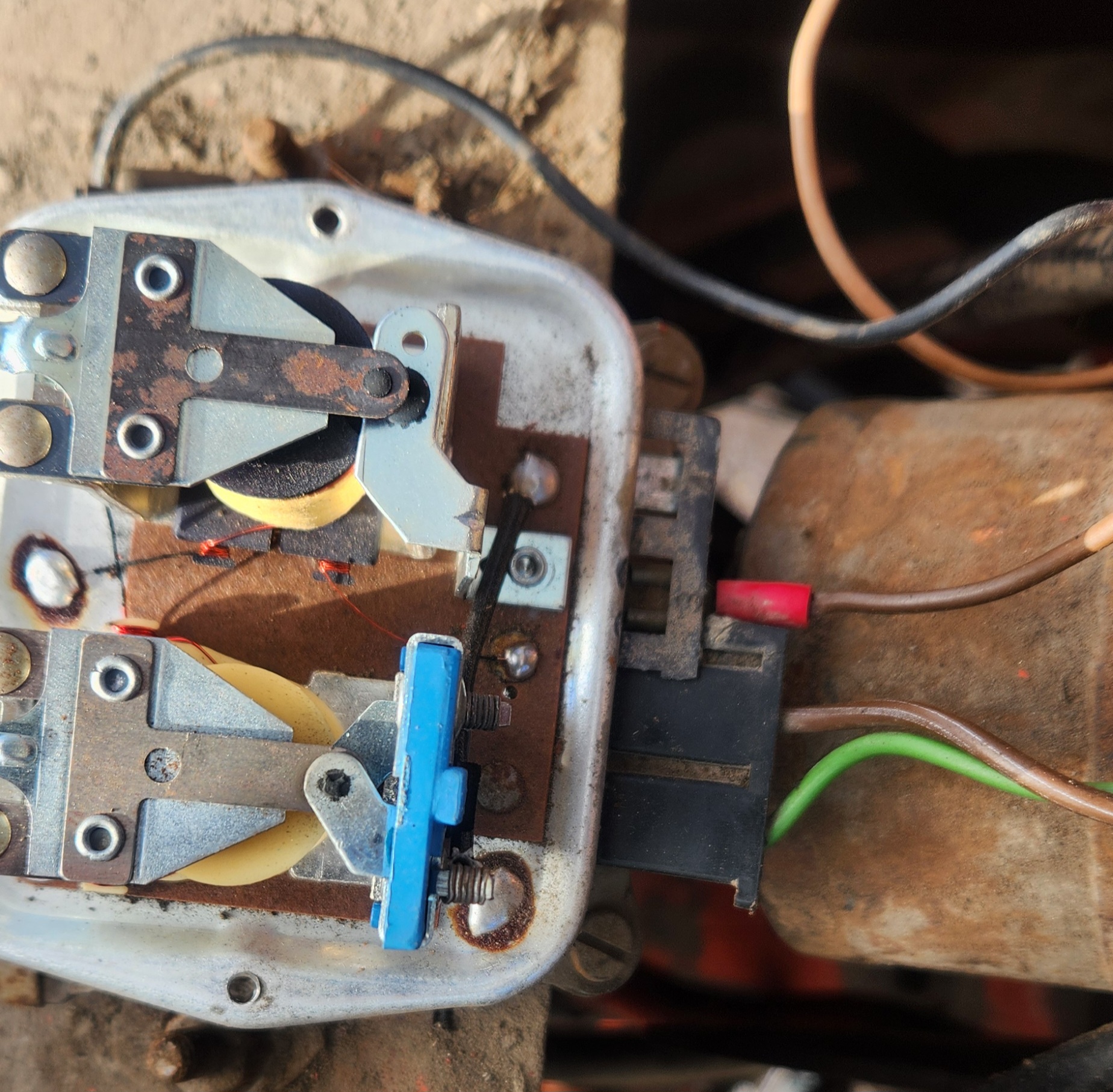

Ok. Wired like this.
The big wire goes to ammeter.
The "F" green wire is original wire harness and connects to the "1" post on Vreg. I've tried in both plugs, there is no marking which is 1 or F. Left it as shown in picture, left plug. The wire is good, makes noise when connecting the meter to both ends.
VReg body is grounded, there is a strap connecting the body to the mounting post and I meter verified it is grounded. There is a spade terminal that isn't connected to anything that is NOT one of the front 4, it's on the side of the VReg, does that need to be grounded separate?
Wire "2" on Vreg goes to the ignition switch. I have a push pull two position switch. It's connected to the open side and connects to 12+ when switch is closed and ignition on.
Pole 3 at Vreg is 12+ always, connected to starter solenoid.

There is no clicking and the VReg doesn't do anything switch on or off, engine running or not, bad solenoid coil in the reg?
The third wire, that little post on the Alt. Whether I plug that boot in or not doesn't change anything.
When I switch lights on I drop to 11.8v, and ammeter shows draw. Lights off I'm back to 12.3v but NO charge.

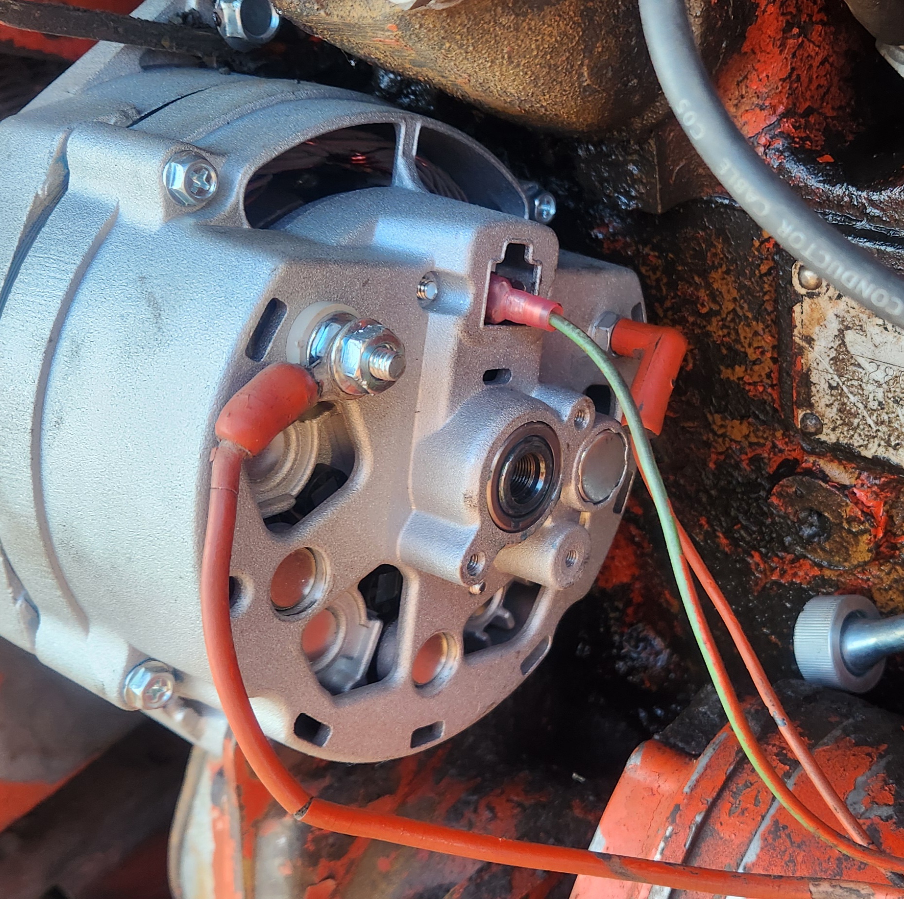

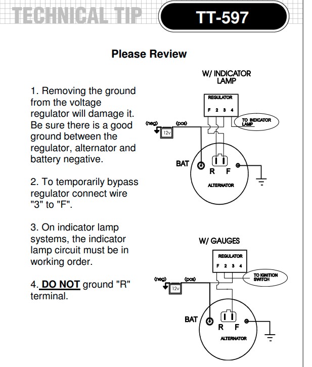

That is a Delcotron (Delco's name for the alternators) model 10DN externally regulated alternator.
Looking at the back of the alternator, the F (field) terminal is the right spade.  The R (reference aka sensing) terminal is the left terminal.
You can test the 10DN alternator by using a jumper wire between the Battery terminal and the F terminal to apply power to it.  This will full field the alternator and it should give you full output power.  Don't run it long that way.
Do not ground the Field wire from the regulator as it supplies power to the alternator field and grounding it can damage the regulator.
If you are trying to use the old regulator, it may be bad.  1. Test the alternator output. 2. Use a test light or voltmeter to test for power from the regulator to the alternator's F terminal.  If the alternator test ok and you don't get power from the regulator, you need a new regulator.  Steve at B&B can confirm, but I believe there are some electronic ones now that might be a replacement for the old ones with mechanical points.

THE EXTERNAL REG SHOULD CLICK WHEN ENERGIZED

Madcow, did you clean the contactor points in regulator? Have 12 volts to the left hand coil. My old regulator mentioned above was a connector that wasn't making connection on terminal 3, Ended up soldering a better connector on.
 Gotta be careful not to ground stuff out that shouldn't be grounded or you let smoke out which you probably know that ain't good in electrics.
Your first pic with red wire from HOT post on alt to first post in alternator , that connector post is used only when you have an idiot light in the system.
If you had connected that red wire to the right hand connector, where you got the green wire, you would have made the alternator go into full power mode and if alternator was good, you would find the back end of alternator, specially the shaft area greatly magnetized.
 Can't imagine anyone would reverse those lugs inside to make the field terminal be in the wrong position... cuzz the rotor brush inside is connected straight to the right spade connector .
