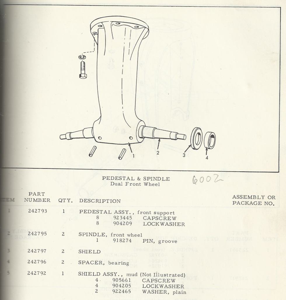

Just gotta ask this again, does anyone have a front pedestal that they will let it be copied to make some sand castings from?
Or supply some dimensions and make a narrow front from some square heavy walled tubing and a plate to fit the steering spindle shaft flange and wled the plate and tubing together. Then find an old narrow front for some farmall like 806 and shove that up the tube and form the end of tubing around spindles and weld solid.

AC720,  One of these days, I am going to stop at a foundry and show them the drawing above and see what they have to say about pouring some casts of the pedestal...  Might be cost prohibitive, but going to give it a shot.
