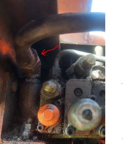

I am attempting to remove the metal hydraulic line that goes out of the hydraulic stack and into the Hydraulic Filter.  I want to place a T adapter for my return hydraulic line coming out of the joystick  right before the hydraulic filter.  Unfortunately, there is little to no room to put a wrench on the nut to remove the steel hydraulic line.   Anyone have any hints on how to loosen that nut?   My 1 1/4 inch wrench has no room to move before it hits the detent and it can only go in there one way.  I thought about ordering a crowfoot wrnech as my next plan if no one has any better ideas.  Thanks for any help.  See pictures below.

Remove the line from the filter base to the sump (will require draining the oil ) and have someone weld/braze a pipe coupling to it and then connect your return.

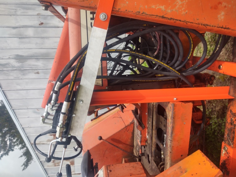

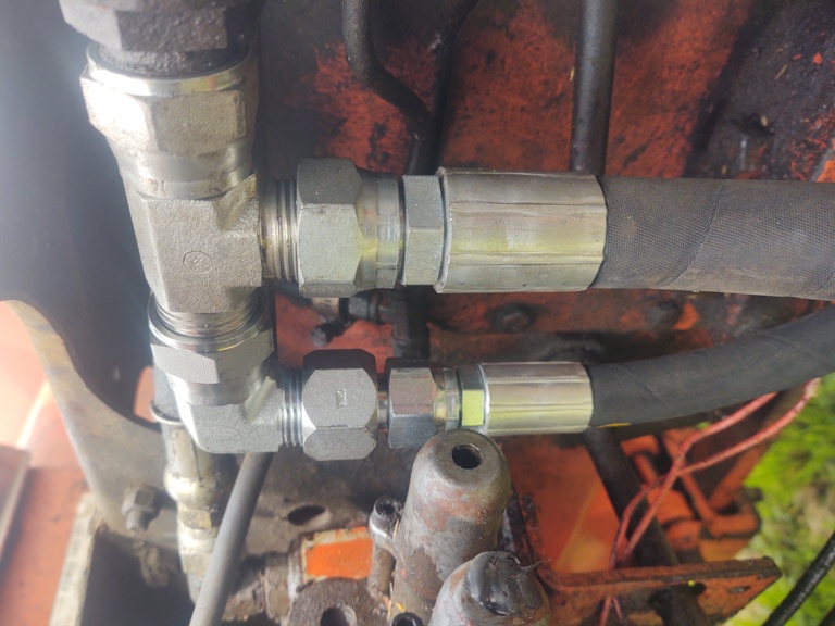

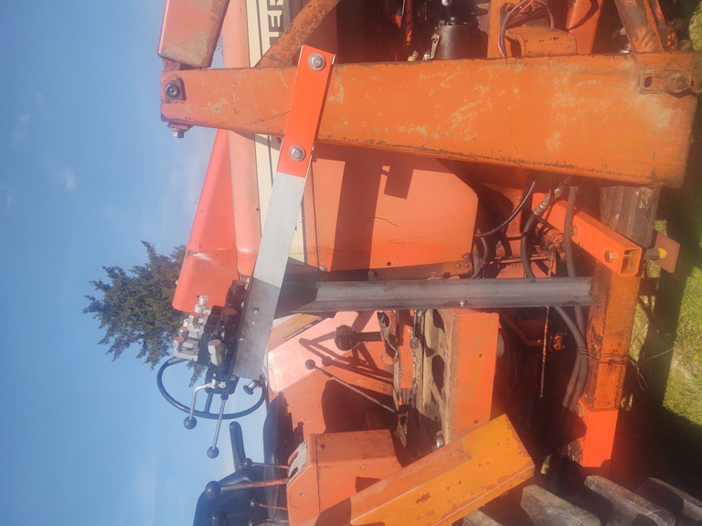

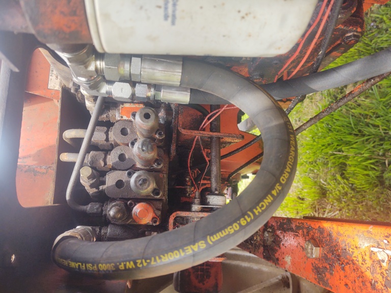

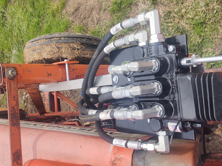

I finally finished this install.  First few pictures were the tricky part that I wasn't sure about originally.  I ended up getting a 3/4 T (SAE 12) and connected it to the filter.  I ended up getting a 2 ft SAE 12 Hose and you can see I had to loop it.  I couldn't find a 1 ft hose in stock and I think that would have been best.  I ended up putting an adapter moving the 12 to a 10 size and ran a 10 hose to the output port on the joystick.  The joystick had all 12 SAE ports.  Due to parts availability I had to get reducers rather than buy an elbow that went from 12 to 10.  I am going to try and make a video of all of the issues to watch out for.
The only problem I have encountered is that the up movement of the boom is slower than when I was using the remotes.  Not sure why?  Should I be using a smaller diameter hose going into the controller?  Princeton manual didn't mention anyway to change the speed.  Slow isn't the end of the world.  It may be safer in some ways.
I have not run the hoses for the bale grabber yet.  I wanted to install it and make sure I know how long the hoses need to be before I buy.
For those that want to tackle this and wondering on cost,  I have $485 into the controller, I have about another $600 in fittings and hoses.   Not to mention the Skidsteer Universal adapter, skidsteer bucket, skidsteer bale spear, skidsteer bale grabber and skidsteer hay grapple.  About double what I have invested in the tractor!  All parts were bought from Surplus Center.   I will say it is really convenient and fast to switch from one implement to the other.  I bought a smaller 5 ft bucket because I feel that the 500 loader matches a 5ft bucket.  That's what I took off of it.
Enjoy the pics and now I have to get my Allis Plow ready!

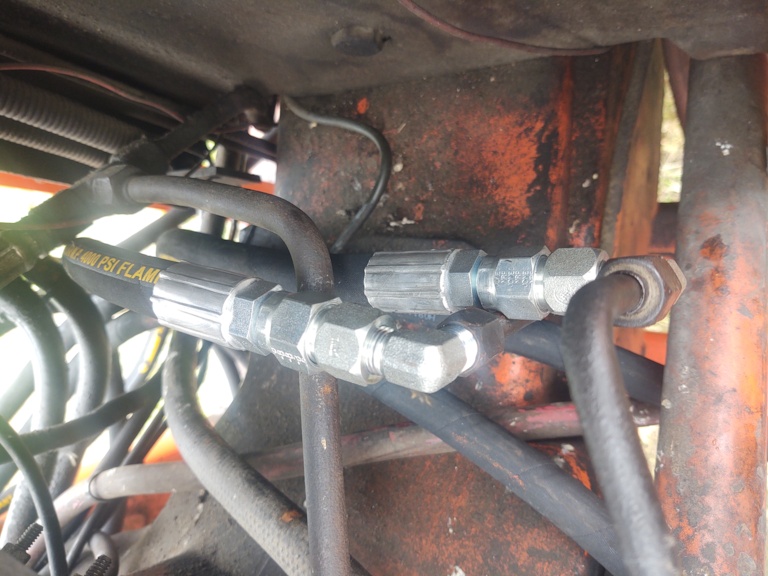

This picture shows where I split the hydraulic line coming out of the pump.  I used SAE 6  Elbow, then converted to SAE 8 for the hose.  At the controller, I went from the pump to the IN port.  The other line is going to the Power Beyond port.
Here is the OUT port hose from the controller on the end of the T, the other T port going down goes back to the hydraulic stack.  I show two shots of this area under the platform.
This shows the mount and fittings.  I got short and extra long elbows so that the lines will fit on top of each other and around each other.  The plate is 12 inches by 12 inches.  I almost made it too close to the tractor but got lucky.
Here is side view.  I think I have enough droop on the lines to install the side panels, but will find out soon.

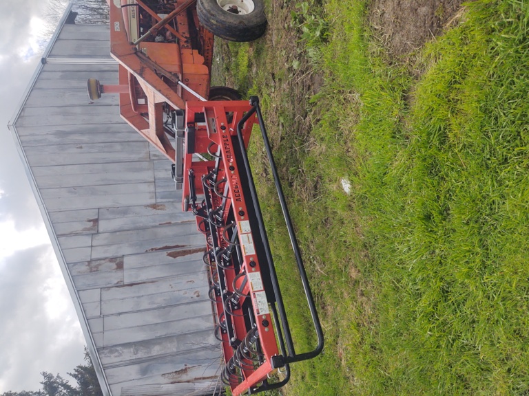

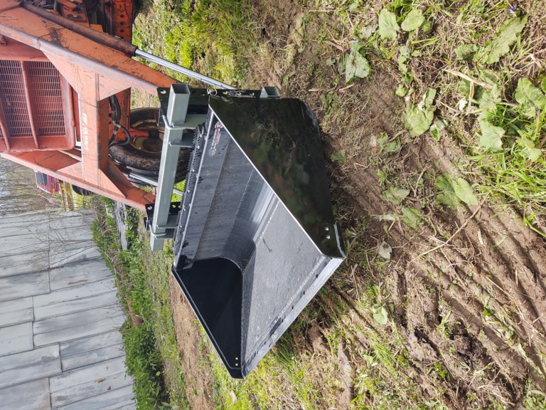

Here is the bucket pic and hay grapple pic.

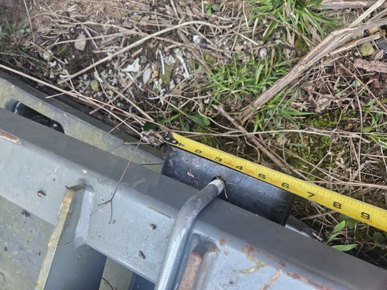

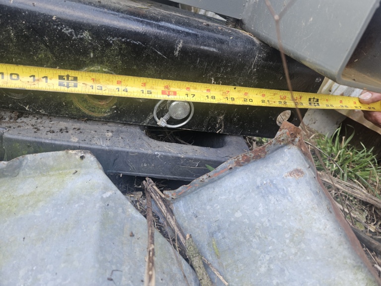

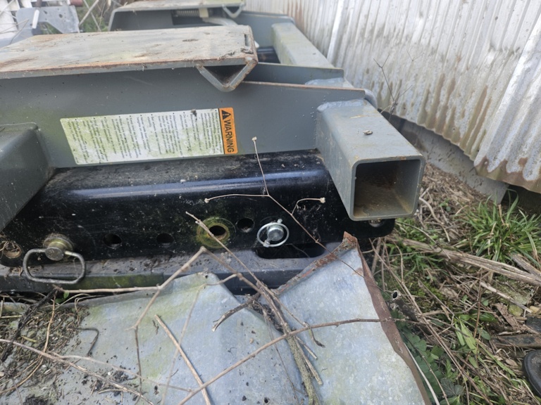

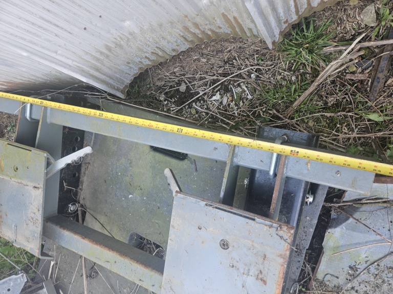

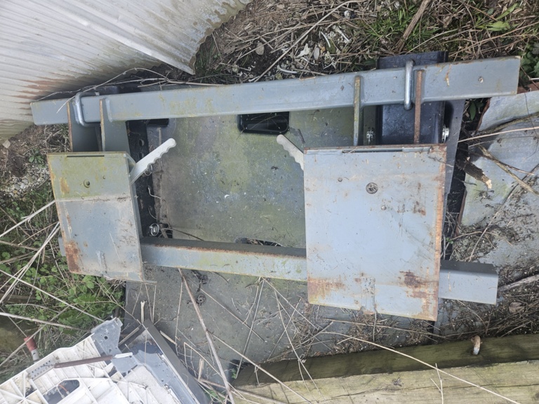

I have some pictures for you.  Basically, you need a skidsteer blank plate that let's you mount two square rails attached to the blank plate.  Then you need 6 inch channel that is 1/2 inch thick by about 24 inches.  That C Channel is attached via U bolts so that it can be adjusted according to the width of your loader arms.   You have to drill holes in that C channel for your hydraulic cylinders to attach via pins.  You can see some of the dimensions in the pictures.  I can do other measurements, if you need them.  Good luck and be sure to post the results back so we can all see your handy work.
You could get  something like this as your starting point and then add the rest.  The single rail isn't tough enough so you would have to add a top and bottom rail for your UBolts.  With a lot of welding and hole drilling you could get something done under $500 assuming you don't have to have the blank shipped to you.  You could also start with standard blank plate and weld the C Channel on specifically for your loader width.  This is a universal so that's why the rails and U Bolts are necessary.  You do have to leave room to be able to latch the handles.  If you use a standard blank plate, you will have to buy those handles and locking pins.  I have seem them for $100.00.
