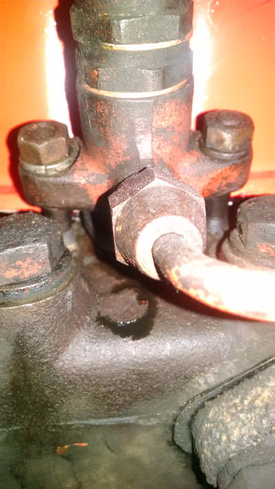

190xt Injector Leak

Even after replacing a valve cover gasket, there will be a certain amount of bleeding that continues until the injector bores are completely dried out. DON'T PANIC WHEN U THINK IT'S STILL LEAKING.
I assume the "bleeding" is from the oil and crud still down in the bore. Prior to removing the injectors I'd plan to use compressed air to blow any debris out of the bore and then loosen injectors, blow out again and remove injectors. Which leads to my question. Is there a safe way to clean the bores out and keep stuff from falling down into the cylinder?

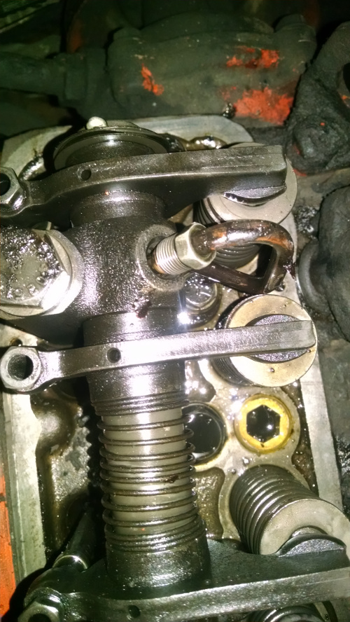

An update on this process for those following it:
1) Before reinstalling the valve cover, I inspected the visible parts.  Turns out that the front oil drain tube was sitting loose.  None of the threads were connected.  As shown below:
2) I am amazed it hadn't fallen out and got caught in something?  I am guessing the oil was simply hitting the top of the valve cover instead of going down into the drain hole.  Not sure if this would have caused any long-term engine damage or not?
3) It seems there is a small sleeve  as shown in the picture below and I can't find it.  Do I really need to get one of these or can I just put it back without the sleeve.  Maybe the missing sleeve has always been missing and that's what caused it to loosen up?  Otherwise, it is pulverized?
4) I made things difficult by selecting what I now think is the wrong glue to attach the gasket to the valve cover.  I saw the Gorilla glue next to the gasket hitack at Autozone and thought it was meant for gluing the gasket.  While it has glued it up and made it stick to the cover, it over expanded once dried.  I couldn't find any 3M glue mentioned above.  I also don't know about it's heat tolerance.  I am considering forging ahead and if it leaks then I will start over.  It also took hours to setup which I thought might be an advantage but in hindsight I had to keep babysitting the gasket.  I stuck the old screws in the holes to keep it mostly aligned and turned it upside down and put weights on it overnight.
5) I used a plastic putty knife on the head edges along with brake cleaner to clean the top, but I have two spots that are not coming clean.  Not sure what do about that yet.  I think I will just keep scrubbing with plastic putty knife.
6) I ended up removing the hood and the turbocharger exhaust elbow directly above the valve cover to make it easier to reinstall, and more importantly to see what I was doing.  I don't think you can do this job correctly without removing the hood in the long run and it really is easy.  My cab created a bit of an issue because I had to lift the hood very high to pass by the turbo tube but I still got it.  Without a cab, it is easy.
7) I did get some small pieces of oil and gasket crud on the head assembly.  I am going to attempt to suck it out with a vacuum.  It crumbles when you try to pick it up though.
So, as always, it got more complicated.  That sleeve doesn't come as a separate part so I will have to order the whole thing, if I really need it, and it is still available.

the sleeve is the brass ferrule that i can see is on the line just below the nut. Just put it back in. The end of the tube may be crimped down to create a resistance, so the oil flows through the rocker arms, and not just out the drain tube.

Thanks Ed.  That's why I like to include pictures in my posts.  How tight should I make it to insure it doesn't come loose in the future?

snug it down tight.

You can get the ferrules at any good hardware store. The vacuum is a good idea. Just start it up before you start scraping and it will get all the fines before they have a chance to get into the engine. You should get a wire brush (a round one) that goes into the bore hole of the inj. and it will clean the side on the hole and the carbon in the bottom. Polish it real good. It will save tons of time.
