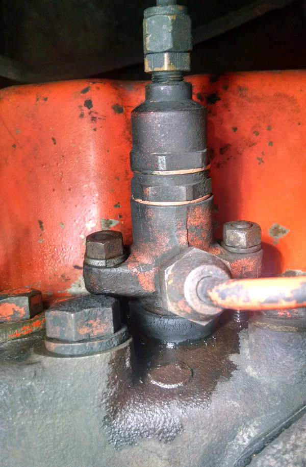

I completely cleaned up the engine and got all the gunk removed.  After doing this and running the engine for about 30 minutes at various rpms, I noticed that my first and sixth fuel injector have a leak, and the other four do not.  I think it is fuel and not oil.  I also noticed that the rubber piece surrounding the first and sixth cylinder looks little more aged than the others.  The tractor starts and runs good, so not real excited about tearing into it, but I thought I would gather comments on how to best stop these two leaks.  I have never installed or de-installed a fuel injector on any motor, so details would be appreciated.  See pic below.

That rubber piece is just a seal to keep debris out of the injector bore.  The combustion is sealed by a copper washer at the injector tip on a 190XT.  You might want to start by checking the torque on the 2 mounting bolts.  Are you sure it's fuel?  If you pressure washed the area, you may have forced some fluid past the seal and it is now being pushed out by thermal expansion.  Probably unlikely, but I have seen stranger things.

Thanks.  I did pressure wash it.  Although, I am pretty sure it was leaking before I did the cleanup, but I couldn't tell which cylinders.  I will check the torque.  That makes sense that the rubber didn't actually seal anything too.

You won't believe it, but it is almost 99% sure it is a valve cover leaking oil. Injectors hardly ever leak down in the bore on that age tractor.

like Doc says,almost always the cover gasket tricking you.Cheap and easy first try.Could probably stand one anyway.

I will see if I can confirm that it is the valve cover tonight, but it would be easy to try that fix with a new valve cover gasket. It probably does need a new gasket on valve cover anyway. So, no need to mess with the fuel injectors just yet.
It seemed odd that it only leaks on the injector side of the motor and only directly above the first and 6th injectors. I see no other oil/fuel leaks at the top of the motor. You would think the gasket leaking would be elsewhere on the motor.
If you look at the picture and the studs used to torque the injector you will see a leak spilling out across the right hand stud. Maybe the valve cover wasn't torqued tightly in those two spots because the return injector lines were in the way?

It appears that it is the valve cover leaking.  I couldn't see very well behind the first injector but the 6th one had oil around edge of the cover.   So, I am going to pursue replacement of valve cover gasket.    I looked at the manual and found the torque specs, but I didn't see a pattern specified so I will just go side to side.

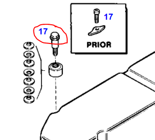

I would seriously consider the Agco bolt kit for that application. It's a set of shoulder bolts with spring washers that keeps constant pressure on the gasket.

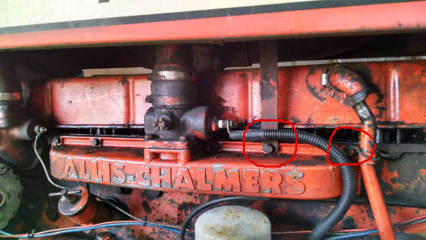

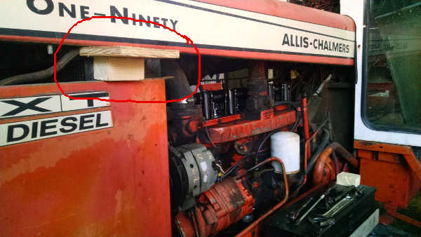

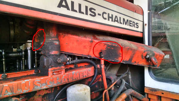

I want to document with pictures what I did on this.  As predicted by DrAllis, my older XT has the higher side panels which means you don't have to jack the hood up as much.  That was good news for me because I have a cab that limited how high I could go.
Here is my starting picture.  Notice that the hood bracket is definitely in the way so I loosed it and pushed upwards.  I disconnected the blowby tube, but didn't remove it.  I also did not want to disconnect the turbo line if at all possible.  So, I thought I had room to pull it towards the front.
I disconnected and removed side panels to get working room.  I disconnected all hood bolts although many were missing.  You can see I put about 2 inches of wood spacers to get the room.
And I pushed up on valve cover and twisted it sideways, pulled it towards the front and out it came.  Notice the two areas that I circled.  This was definitely leaking oil.  Ironically, I noticed the leaks on the other side next to the injectors as leaking worse.  When I cleaned the gasket material off of the valve cover, there was a noticeable area where this was leaking on this side.  On the injector side, it looked good.  I am going to clean up and probably paint the valve cover since it is off, so it will be a little while before I can put it back on.  According to the manual, it says 4 lbs of torque, which seems not very much.  However, it didn't take a lot of pulling on the cover screws to get them loose.  I haven't been able to locate those special screws off of the 7040 mentioned earlier.  Seems they come in different models.

Found this when looking up a 7040. Is this the new style bolt with spring that you guys are talking about? Looks like a good fix if leaks tend to be an issue on these
"Fastener Kit" p/n 74036977

Dave that is the one!!
They are great, I have changed all my tractors over to them.
