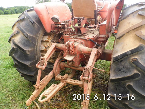

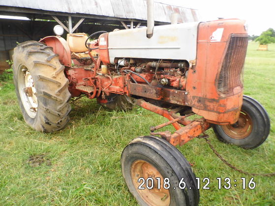

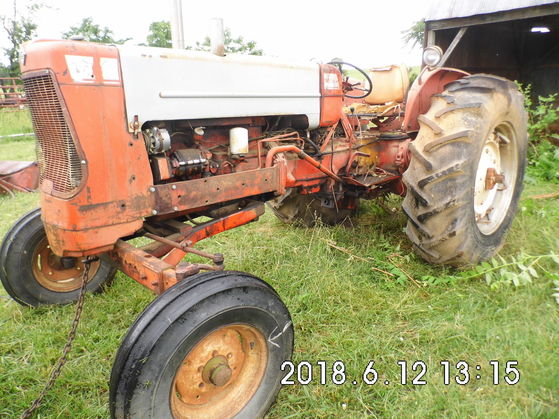

Barnabas, 180 engine won't work any better than a 190XT engine... same dimensions...  But it is possible to be done.+
D19 with 190 engine...
 anything is possible, this engine has the Simms pump... sure would have been a honey I think if it was running.
Looks like this 19 had some real heavy inside weights in the rear wheels...
2700 bucks, 110 hp combine engine...

JC (WI)   I'd like to see how they did the power steering on that tractor. There's not enough room for the steering cylinder to clear the engine on the right side, so how did they do it ??   Looking closer, it appears to have a 190 front axle with the steering cylinder inside the axle frame, so there must be an orbitrol connected to the steering wheel.
JC-WI View Drop Down
Points: 34627
Post Options Post Options   Thanks (0) Thanks(0)   Quote JC-WI Quote  Post ReplyReply Direct Link To This Post Posted: 16 Aug 2018 at 10:32am
Dr. Allis, if you look real close, I believe they used the 190 frame in it up to the radiator shroud and used the D19 frame forward. They used the 190 front axle assembly and D19 front casting.  And you can see the hydraulic hoses by the starter coming down  for the steer cylinder.  Does look good in the picture.
 Wonder if they had used the D19 elbow or the origional 190 turbo elbow.
