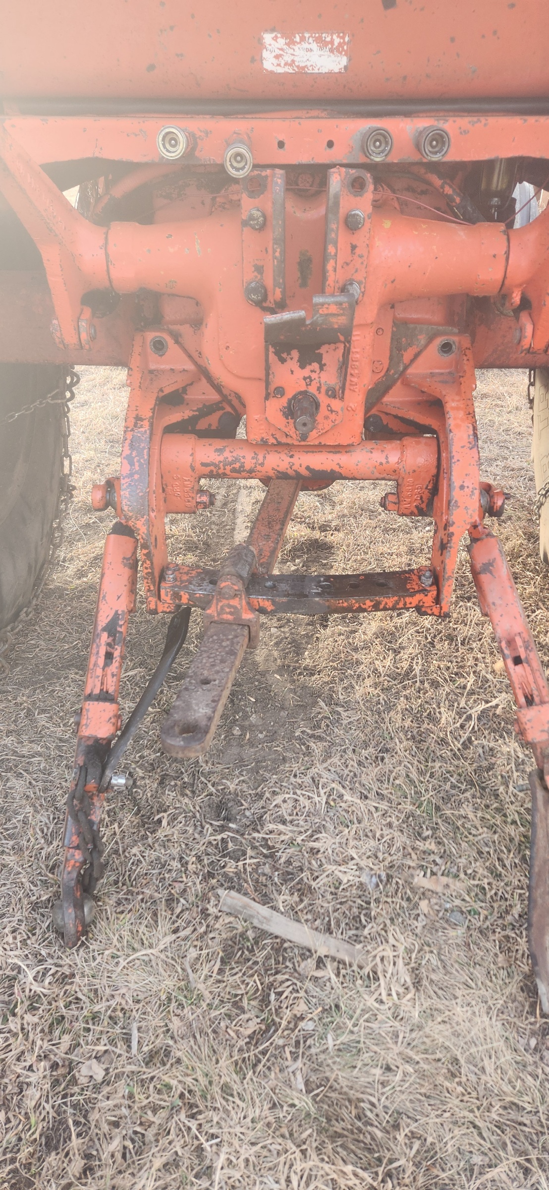

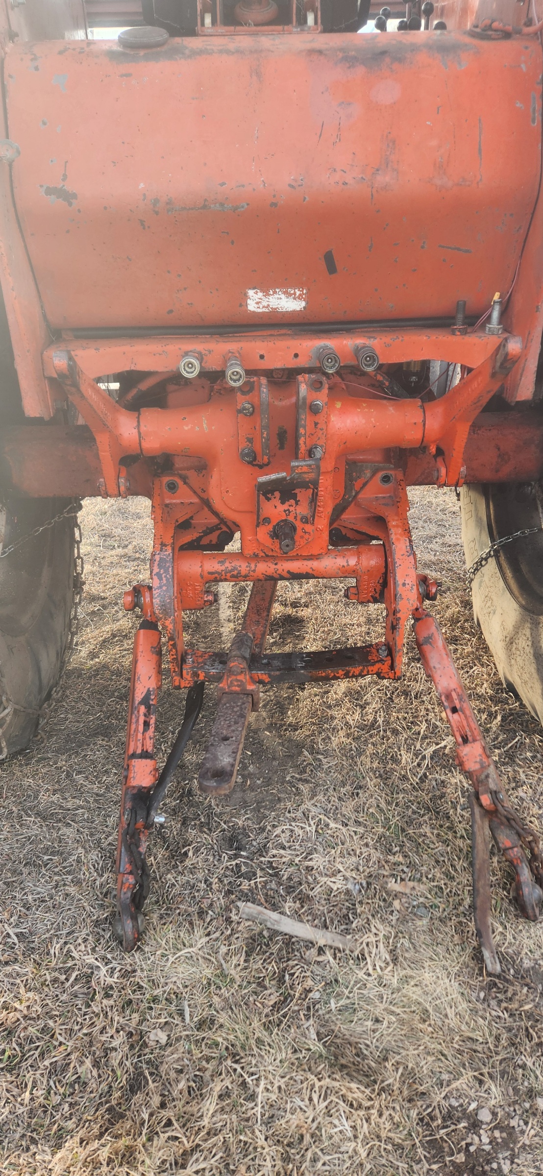

What do I need to remove on this to be and to use snap coupler again? Everything?

Looks like you need a drawbar and bail at least. Your drawbar might adapt?
Good luck with the project, not many snap-coupler 190's around! I've got a buddy that would like to own one.

It all has to be dropped off. 6 bolts and you are there. The snap-coupler tongue comes right up to the PTO housing when fully lifted up.
